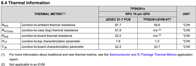

Hi Ti Team,
Greetings!
We like to know the Junction to board thermal resistance, Junction to Case (bottom) thermal resistance and Case Temp (°C) Max of TPS62913RPUR
Hi Ti Team,
Greetings!
