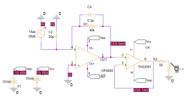

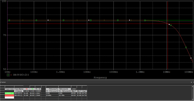

I am currently designing a TIA circuit with a bandwidth of approximately 10 MHz. The circuit is as follows:

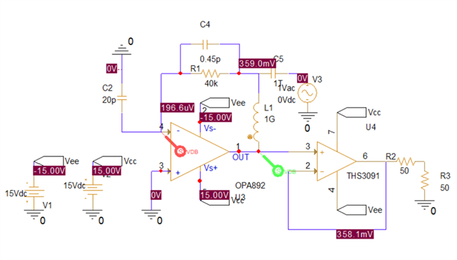

Previously, in a circuit without a buffer, I was able to analyze the phase margin by examining the loop gain using an inductor and capacitor.
However, I encountered an issue where, to achieve the maximum voltage output of the OPA892, I need approximately 260 mA of current in a 50-ohm system (assuming a 13V output). To address this, I added a buffer circuit.

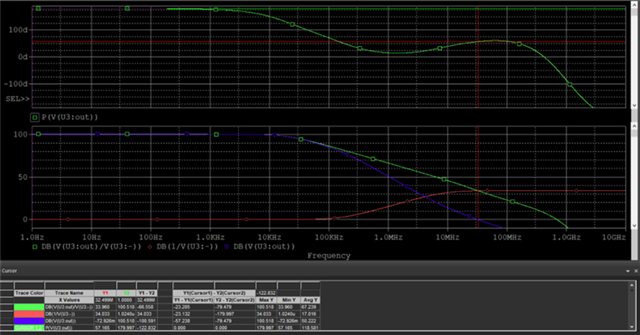

1. Phase Margin Analysis with a Buffer
In this case, is it still valid to analyze the phase margin using the same method as before (loop gain analysis with an inductor and capacitor)?

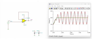

2. Stability of the Buffer Circuit
I have configured the buffer circuit by directly feeding back to the inverting terminal. Are there any additional steps I should take to ensure the stability of the circuit?

    Thank you for providing all the detailed information and schematics.
    1. For analysing the phase margin, you should analyse both the circuits, TIA and buffer, separately by breaking 1 loop at a time, for stability. The second schematic that you have sent looks correct to me, you can do the same for the buffer circuit, to analyse buffer stability.
      So it is still valid to analyze the phase margin using the same method as before (loop gain analysis with an inductor and capacitor).

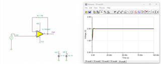

    2. If you plan to use this THS3091 in a gain of 1V/V, you will need to add a feedback resistor to the circuit and cannot directly short the output to the input. Since this is a current feedback amplifier, its stability is dependent on the feedback resistance. I recommend using Rf = 1.78kΩ as mentioned in the datasheet (page 20, section 8.4.1).
    3. Regarding the optimal phase margin, while 45-60 degrees is a good starting point, the specific requirements application may benefit from a higher phase margin. A 70-degree phase margin can offer increased stability and less overshoot. However, this often comes at the cost of slightly reduced bandwidth. The best approach is to simulate your circuit with different phase margins and evaluate the trade-off between stability, overshoot, and bandwidth to determine the optimal value for your specific needs.
