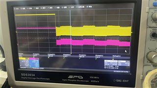

Please review our schematic that the PIN18 and PIN19 output abnormal when there are some interference signal, the waveform refer to below:
Schematic diagram:

    May I ask where these interference signals are coming from?
    Robert Clifton
  • Hi Robert,
    We need to pass the RSCS testing and there are about 1GHz Wireless Signal for this testing, and we use the 433MHz interphone to close the board
    to Simulate this testing, and the PIN18 and PIN19 will be automatic recovery if we remove this interference source,

  • Hi Zhang,
    Thank you for the additional information.
    Have you verified that the interference isn't coming from the 3.3V supplies?
    Has this interference propagated to the OD pin? Has it caused to shutdown?
    Also the EF_CM and EF_LD should not be tied together. I'd recommend lowering the pull up resistor values of all of the error flag pins. I don't believe that should be the cause of the problems you are seeing but it's a serious concern.
    The product don't shutdown when we close up the RF interference source, it is only alarm from the MCU(The fault is LED flashing),
    Also the EF_CM and EF_LD should not be tied together. I'd recommend lowering the pull up resistor values of all of the error flag pins. I'm don't believe that should be the cause of the problems you are seeing but it's a serious concern.
    We will test based on your suggestion, and will feedback to you soon.
    BTW, we consider it is the radiation impact so can you help to check if there are any report for the radiation testing?

  • Hi Zhang,
    We modify our design based on your comment, but the issue is still exists, so pleaes kindly help how to solve this, thanks.
    Did you separate the EF_CM and EF_LD pins? Did you also lower the resistance of all of the EF pull up resistors?
    I was able to find that we did have some EMC testing done for reference designs for the XTR300 and XTR305. See here: https://www.ti.com/lit/ug/tidu434/tidu434.pdf and https://www.ti.com/lit/ug/tidue87/tidue87.pdf. The documents refer to IEC61000-4 and IEC61800-3 mostly. However it's focusing in on the output signals rather than the error flags.
    Perhaps it's time to take a step back from this and look at the error flags on their own. Let's assume that the fault conditions that are occurring on the EF pins are from actual fault conditions. Have you confirmed that none of the other pins experience any change during this RSCS testing?
