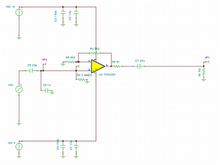

My customer build a circuit using the THS3001 however the waveforme is different. the differences are only LOT accourding to cusomter.
Can you advise why the differences happend?
>>> Customer questio & Request>>>
The square wave is input at 5kHz, ±5V, and a square wave of 50mV (reduced to 1/100) should be output by capacitive voltage division (see output voltage).
The square wave is distorted depending on the production lot (this has not been observed in simulations). I would like to know the cause of the distortion.

    I was able to simulate the circuit and got a similar result as the square wave the customer is seeing.  Could you try reducing the input resistor to 100k instead of the 2.4MOhm on the board. If you adjust this resistor for the lot giving you a square output, do you see the signal behave more like the other signals?

    The concern with the very large input resistor on the non-inverting pin is due to the non-inverting input bias current. The device has a max value of 15uA across temperature, which would cause an offset at the output. Due to lot variation one possible scenario is that some units are not as affected by the large resistance, but others could have a larger bias current which could be causing the device to fall outside its linear region. Decreasing this resistance value would be a good debug step to see if the circuit performance changes.

    There was a PCN issued as we transitioned to a new fab process. I was able to compare and found the inverting and non-inverting impedance did not change. The THS3491 is a very different device to the THS3001, so I am not sure we can compare the two devices. Was the customer able to adjust the resistor at the input?
