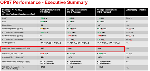

May I learn from you about output impedance value of OP07CP?
I have check the value is 60-ohm, but cannot find it from device datasheet. Please help to confirm it, thanks.

Hi Ben,
There is PCN issued in OP07 product, and the BW and open loop output impedance are changed slightly due to the FAB change, see the table below.
