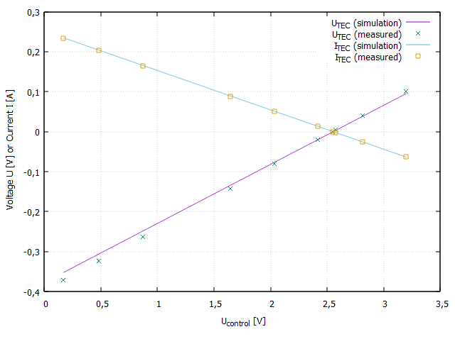

    In checked the real circuit: I disconnected Voffset by removing resistor R1, RG is 2700 Ohm and all feedback resistors are 510 Ohm. U_Bias is at 2.55V.
    This is the data that I collected compared to the simulated values:
    Scrutinizing my setup, I noticed that my amps meter adds an input burden of 2 mV/mA. ‍Rolling eyes  In other words, the amps meter increases the resistance of the load from 1.5 Ohm to 3.5 Ohm. Therefore the real circuit has to provide about twice the gain compared to the simulation. I unintentionally "corrected" this difference by reducing the gain of the simulation by halving Rf.
    Does that make sense to you?

    I have not experienced this myself, but I can see what you found to be very plausible. It is adding an offset to one side of the resistor (where you're measuring from) and is therefore reducing the voltage difference across the resistor and therefore reduces the current through the resistor. It is reducing what is expected and why reducing the simulation gain gives the same result. You are dealing with such a small load that millivolts of offset will affect your results which could be what was happening in this case. If so, this was a great catch!
