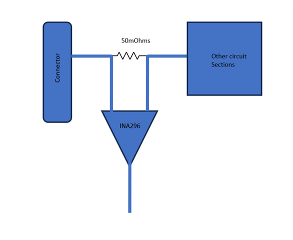

INA296A: Seeing there is a -400mV in the path where am measuring the current
Part Number: INA296A
Other Parts Discussed in Thread: INA199,
We are using the INA296A2IDDFR current sense amplifier in the measurement path. After power-on, we are observing approximately –400 mV at the measurement node. When the current sense amplifier is removed, the voltage at the same node is close to zero. Please clarify whether this behavior is due to an offset or any other characteristic of the current sense device.
For reference
Supply - 5VDC
REF1,REF2 connected to GND/2.25Ref voltage through a switch
