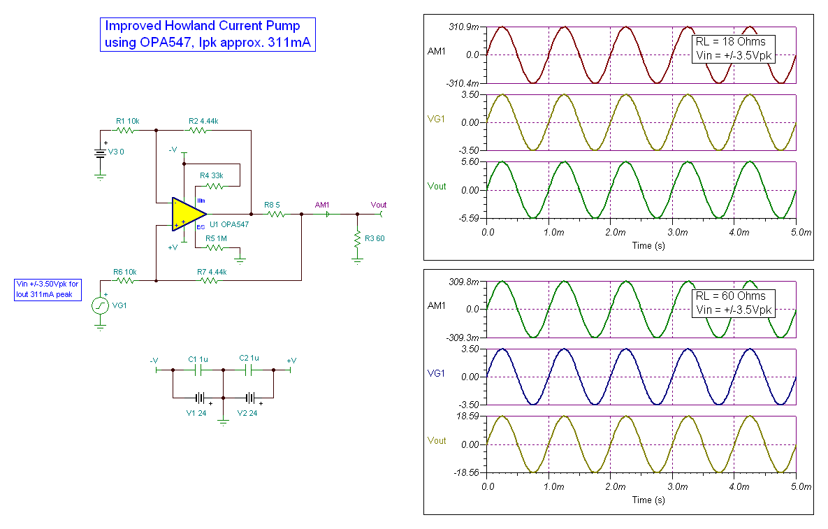

I want to design a constant AC current source of current variable upto +/-400mA.
The frequency of the current source will be max 100Hz.
Can somebody tell me whether Ti has a readymade solution for this?
I came across Improved howland current pump using OPA547 for Ipk approx.311mA, attached below. But we required for +/-400mA and input volatge range is +/-10V.Could you please share the relevant circuit for this?
e2e.ti.com/.../constant-ac-current-source
  • Hi Lathaniveatha,
    You are on the right path here, yes the OPA547 is the most suited device for your application requirements.
    What are your accuracy requirements in this application? What input range do you want for this design?
     I can design similar circuit for your desired implementation.
    Jacob

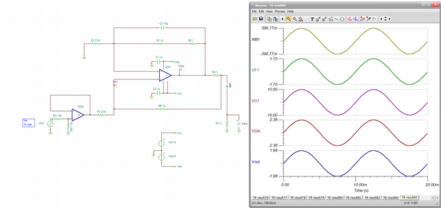

    We have simulated the circuit you shared using the ALM2402 (img attached). However, at a ±10V input, we are observing an output current of ±550mA instead of the expected ±400mA.
    We used the simulation model from the TI website. Since we couldn’t access dual-channel pinouts, we simulated using two ALM2402 ICs.
    Also, could you please confirm if the ALM2402 can operate with a ±15V supply? I have attached the table of required output current and voltage.Output voltage from 0.47 to 5V. Alternatively, if we ignore the 50mA at 100Ω condition, is it possible to use the device with a ±5V supply?
    Lastly, could you please share the formula for calculating the resistor values?
    Thanks in advance!

    In short, all of the ALM240x models have quirks which may not be perfectly representative of the actual device performance. Due to this, I simulated using an ideal model, and consulted the datasheet for confirmation as for if I believed this would work in real implementation.
    Sorry for not sharing my sim files in my last post. You have done a great job of replicating my simulation, TINA however decided to not connect R4, R%, and C1 together (see lack of a dot at this intersection).
    Since there is little feedback mechanism here, we are actually stuck at VOL, and the slight changing in AC current is due to the model having some common mode dependencies:
    All being said, even if we did connect this feedback, we would still see that the ALM2402 model does not want to output 400mA under certain scenarios.
    Again, I know that the real device will do so, this is just a claw limit issue with the model.
    I still believe there will be some error associated with the small 1 ohm RHCP resistor in the original design I suggested. You asked for the formula, and hopefully this will help illustrate why this can be impactful:
    Iout = {G x (Vp -Vn)}/ RHCP
    G= Rf+RHCP/Rin when the following is true:
    RF=RFP
    Rin1=Rin2
    RHCP=Rcomp
    For this new design, I have a gain of
    Iout = {(1005/5000) * +-10V)}/5 = +-.402A
    trace resistance will add to this RHCP resistor, and resistor mismatch will add more error to this design. Generally, we want to make RHCP large enough to help with gain error, yet not make it so large that we see large power losses in the Howland resistor.
    Howland ALM2403.TSC

  • Hi Jacob,
    Could you please review the circuits below, which were simulated using the ALM2403-Q1 for various input and supply voltage conditions? The output current swing in the last iteration isn’t as expected, but we believe the other two circuits are functioning correctly.
    Supply-12V, Vin-10V
    Supply-12V, Vin-10V
    Supply-7V, Vin-5V
  • Hi Lathaniveatha,
    400mA is right on the edge of what I would recommend with one ALM2403-Q1, likely better suited to use both channels of ALM2403-Q1 in parallel.
    Something like this could work:
    Jacob.
