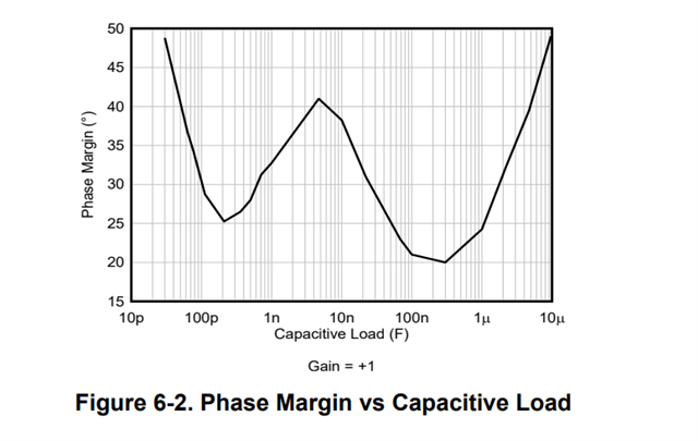

    You are on the correct path here. A power amp with lots of loop compensation can get the job done, but the power amp itself is driving such a light resistive load that the system will hardly benefit from the high IOUT capacity of the power amp.
    Fortunately, we make a one chip solution, being OPA994. This device is specially designed to automatically compensate the GBWP based on the load capacitance seen at the output. This means no need for RISO or multi-feedback design.
    Our curve only goes out to 10uF, but trust me in that this device continues to drive as large of a capacitor as you can practically find.
    Understand that while this device is 24MHz of BW, this goes down significantly as Cload increases. The model can be used to test with your system.
    INA826 will unfortunately become destabilized due to the high cap loading. It may be possible however to use the INA826 and the OPA994 together to have ground separation with high voltage input tolerance, and high cap load output drive.
