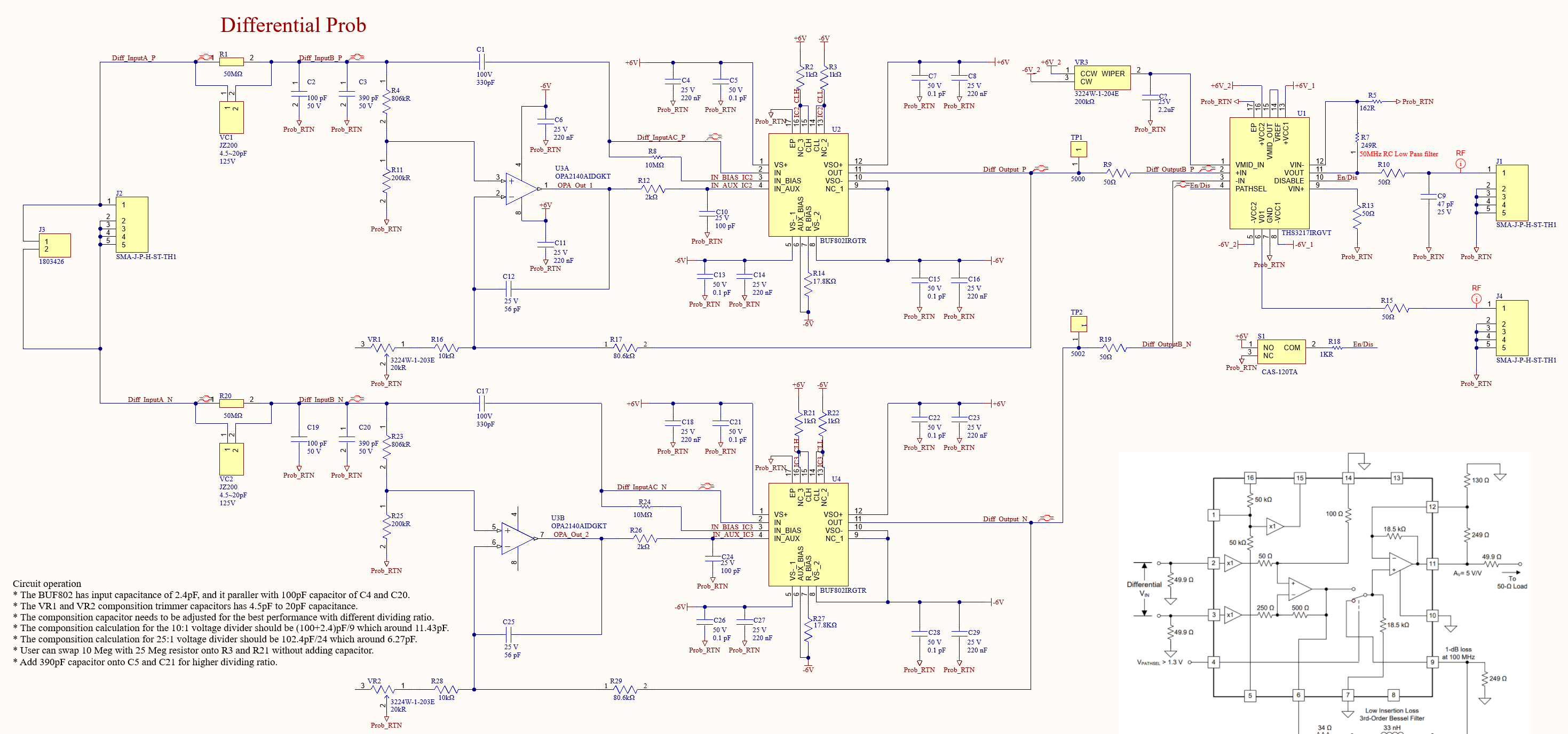

I have designed a differential amplifier using two BUF802s and a THS3217, and we have assembled a few boards for testing. The design includes two output options from the THS3217: VO1, which has no filter, and VOUT, which includes a 50 MHz filter. The performance has been excellent; however, I have encountered some issues that I would like to address for the next iteration.
When the board is not connected to the function generator (open input), it exhibits noise levels of approximately +/- 1.5 to 2V. Shorting both inputs together does not seem to have any effect. When the board is connected to the function generator, oscillations occur when the orientation of the cables is changed. We have replaced several cables, but this has not resolved the issue.
I am considering replacing (VR1 + R16) and (VR2 + R28) with fixed 20k resistors with a tolerance of 1% or 0.1%. Would this change have any negative impact?
Additionally, regarding R9 and R19, should I use 10 ohm, 50 ohm, or remove them entirely? The distance on the PCB is approximately 220 mils.

  • Hi Ignacio,
    Thank you for the reply, I will try your suggestion above. I did more testing last week, the output at TP1 and TP2 looks clean, but it shows10mV noise after R17 and R19. I think about instrumentation amplifier front end setup(see the picture below), and I wonder that at VR1 and VR2, should we connect return to each other instead to ground for differential input? can the CMRR error cause that noise issue?

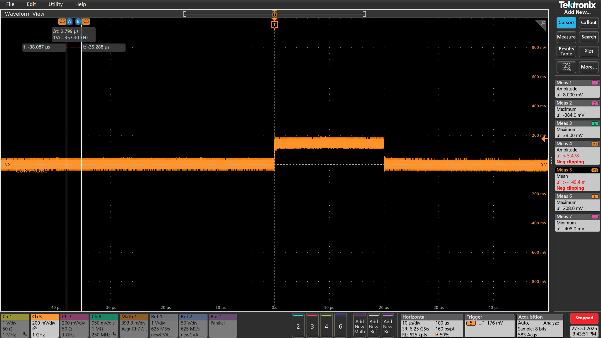

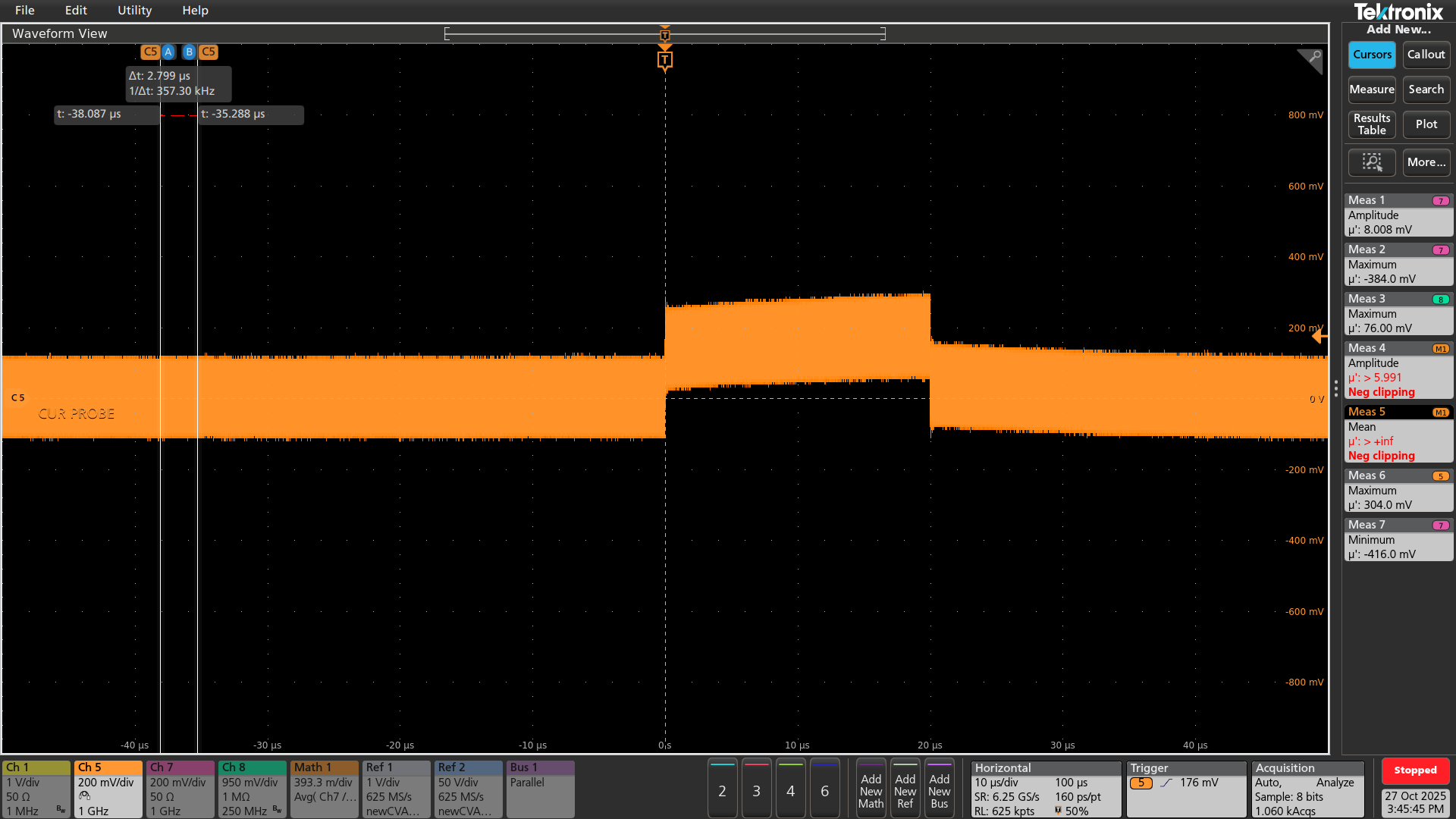

    The two picture below shows that unstable output wit 20u pulse signal.
    I removed R9 and R19 isolated it from THS3217, and I input 20u pulse signal and measure the signal with end probe. This is output at C2
     This is output at TP1
    There is an interesting thing I found during this test, after my single end probe touched R17 pin1 then repeat the same measurement above, the signal become clean like below until I touch the TP1.
    I wonder what can cause the feedback loop for OPA140 noise? and I use OPA2140 with .22uF decoupling capacitor, should I increase capacitance? Do you allow to have MS teams meeting? I will like speak with you if that is possible.

  • Hi Ignacio,
    The measurement at C2 is very noisy, but noise drop down after scope probe touch HF path at R10, and it stay less noise until I touch output of BUF802. The picture below shows before and after. I have two questions at this moment.
    1. The BUF802 CLH and CLL option since I have not use it, would that cause output error?
    2. I did look https://www.diva-portal.org/smash/get/diva2:1913874/FULLTEXT01.pdf which use same design base, they use 2x 10:1 divider before the BUF802. Would that setup perform better compare my setup?
    3. They use 30ohm resistor before C1, what is the purpuse of that resistor
     Before
     After
