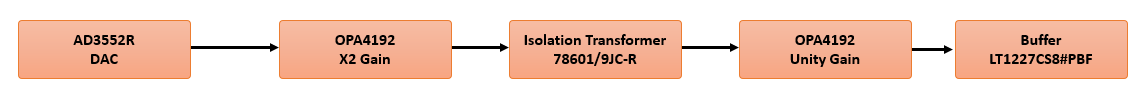

I'm using the amplifier OPA4192IPWR in my board. I'm providing the output of the DAC AD3552R to the OPA4192 amplifier in my design and also used as a unity gain amplifier in another case.
The signal chain diagram is shared below
1. As it is a channel amplifier, i want only the 3 channels for my application. Can i make the unused channel as NC or any specific termination is required.
2.Is Riso resistor and Cload is mandatory in the circuit. If mandatory which values should I choose.
3.For unity gain amplifier does the below circuit is correct. Please confirm whether Riso and Cload values are okay.

    1.In the current board design, the output of the AD3552R DAC is first processed by an OPA4192 configured as a transimpedance amplifier. The signal then passes through an isolation transformer, followed by a unity-gain filter stage using another OPA4192. Finally, the signal is buffered using an LT1227CS8#PBF.
    Could you please confirm whether cascading these two buffer/amplifier stages could introduce any signal integrity issues or signal loss in the system?
    2.In the second case, a single output from the OPA192 amplifier is distributed to 14 channels of OPAx192 series buffer amplifiers.
    Could you please confirm whether feeding one signal into 14 buffer amplifier channels could introduce any loading, signal integrity, or stability issues?
    Abhishek
  • Abhishek,
    1. Cascading two buffers will have minimal impact on signal integrity.  Each amplifier will have some noise and distortion, so the total noise and distortion will be slightly worse.
    2. Connecting an OPA192 to the input of 14 OPA192 buffers should not be a problem.  Each OPA192 has about 1pF of input capacitance.  The traces will also add input capacitance.  Assuming the total trace capacitance is 10pF, the capacitive load will be 14pF + 10pF.  The OPA192 can drive over 200pF so you should not have any stability problems.  The input impedance of OPA192 is very high so that will not load the amp either.  As a precaution you could add a 10 ohm resistor between the driving amp and the 14 buffers.
