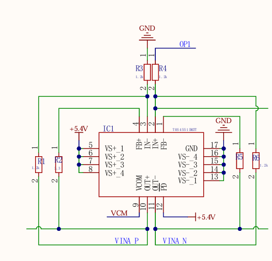

I am using the THS4551IRGTT (16-pin VQFN package) as a fully differential amplifier to drive an AD9257 ADC. The ADC operates with AVDD = 1.8 V and provides a VCM of 0.9 V (AVDD/2), which is connected to the THS4551 VOCM pin. The THS4551 is powered from a single 5.4 V supply.
My resistor values are R1 = R3 = R4 = R6 = 1.2 kOhm and R2 = R5 = 3.3 Ohm in a single-ended to differential configuration. The input signal is a single-ended analog signal with a maximum amplitude of 2.8 V peak. I would like to keep the THS4551 differential output below 1.8 Vpp to avoid overdriving the AD9257 inputs.
Could you please confirm whether this resistor configuration is appropriate, or whether the THS4551 output will saturate with this input signal level?
I would also like to understand the role of the FB+ and FB- pins in this configuration and how they affect gain setting and FDA operation.
In addition, I would appreciate guidance on how to verify the design using TINA-TI or PSpice. Which simulations should be performed to confirm that the output common-mode voltage remains at 0.9 V, the amplifier operates linearly without clipping, and the differential output swing remains within the ADC input range?
Is transient analysis of OUT+, OUT-, and the differential output (OUT+ minus OUT-) sufficient, or are there other recommended simulations or measurements?
Finally, is it practical to validate this design on hardware using an evaluation board or prototype setup before committing to a PCB design?
  • Hi Nishant,
    The FB+ and FB- pins are the outputs of the amplifier, brought to the other side of the package to allow for easy routing for feedback without having to go all the way around. This means the feedback resistors on pin 2 goes to pin 1 and pin 3 goes to pin 4. Your schematic will need to be altered then, the 3.3ohm resistors are currently in parallel with the 1.2kohm feedback.
    I'm assuming the 3.3ohm is meant to be isolation within the feedback.
    If your input signal is 2.8V peak, is that 2.8Vpp (+/-1.4V) or 0V --> 2.8V? That will help determine if your gain is correct to limit the output to 1.8Vpp for the ADC. If it is 2.8V peak I think the output will saturate you might have to attenuate it.
    For simulation, I would have one to double check DC input/output common-mode voltage ranges and transient response for output ranges, can also be used to check frequency response. You can use this file attached for example:

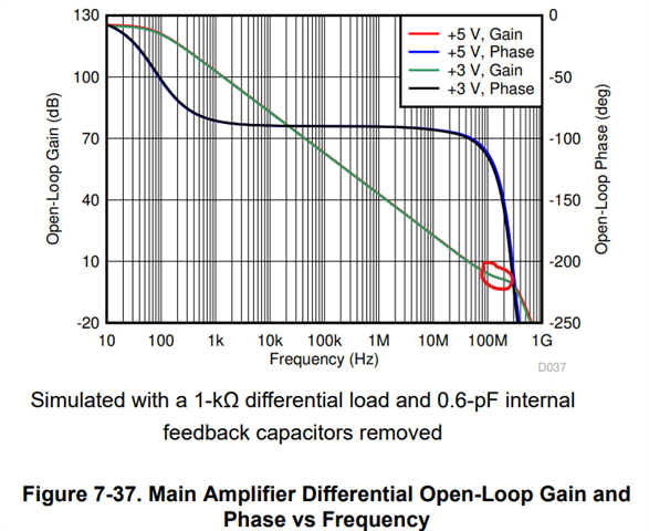

    However I would also check stability with this file attached. Here you can check loop gain and phase margin with whatever capacitive load or filter you might be expecting to drive the ADC. I would keep the split supplies here the model seems to react funny when you do a single-supply.

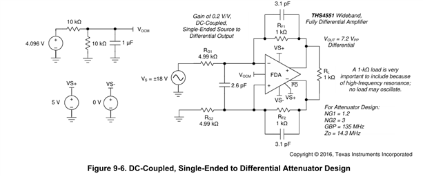

    1. I would like to use this example circuit as a reference to troubleshoot my hardware. In my design, the THS4551 is connected to an ADC, and the VOCM pin is driven with the ADC VCM output (0.9 V).
    2. With no input signal connected, I observe noise/oscillation at the outputs. Additionally, both VOUT+ and VOUT− measure approximately 1.8 V. I am unable to understand why the outputs are at this level when no input is applied. Could this indicate an issue with the common-mode loop, feedback network, ADC loading, or circuit stability?
    3. The example shows an input signal of ±18 V while the THS4551 is powered from a 5 V supply. Could you please explain how the circuit processes this input and what the expected output waveform and voltage levels are? When attempting to simulate the Page 33 example circuit, I am encountering SPICE convergence issues and am unable to obtain a stable operating point. Are there any recommended simulation settings, initial conditions, or analysis procedures that should be used with the THS4551 macro model?
    4. Canyou please provide the simulation analysis for that circuit.
    Could you please advise:
    • How to analyze the Page 33 circuit step-by-step?
    • What output voltages should be expected with no input applied?
    • Whether this reference circuit can help identify the cause of the oscillation and 1.8 V output level noise observed in my hardware?
    Thank you for your guidance.
  • Hi Nishant,
    For your hardware, is it the same schematic as your first post? I wouldn't think it is an issue with the common-mode loop, but more an issue with the feedback/stability or ADC loading. What load is it driving? If you play with any of those parameters does the situation change?
    Figure 9-6 works because it is in a attenuator configuration. G = Rf/Rg = 1k/4.99k = 0.2V/V. The paragraph just below the figure does a good job describing the considerations.
    To summarize it though:
    Voltage Biasing:
    • Output common-mode voltage (VOCM) = 4.096 V / 2 = 2.048 V
    • Source signal common-mode (VCM) = 0 V
    • Nominal input pin voltage (VICM), this is a resistor divider from Vocm to the input pins with the Rf/Rg = 2.048 V × 4.99 kΩ / (4.99 kΩ + 1 kΩ) = 1.71 V
    Output Swing:
    • A ±18 V input applied with G=0.2V/V gain produces a 7.2-VPP differential output
    • This corresponds to 3.6Vpp on each output or ±1.8 V swing on each output side around the 2.048 V common-mode
    • The resulting output range is 0.248 V to 3.84 V (relative to ground), well within the 0.2 V headroom margins of the 0–5 V supply rails
    Input Common-Mode Swing:
    • The output swing feeds back an attenuated input common-mode swing: ±1.8 V × (4.99 kΩ / 5.99 kΩ) = ±1.5 V around the 1.71 V bias
    • Input common-mode range: 0.2 V to 3.2 V, safely within the available -0.1 V to 3.8 V input range
    Source Requirements:
    • The source must sink 0.34 mA (2.048 V / 5.99 kΩ) of common-mode level-shifting current to bring the 0 V input VCM up to the 1.71 V operating point
    • The source must also drive an apparent input load of 5.44 kΩ (per Equation 4 in the datasheet)
    You can see the attached TINA file to play with these considerations.
    THS4551 Figure 9-6.TSC
    Evan

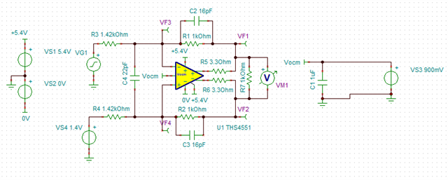

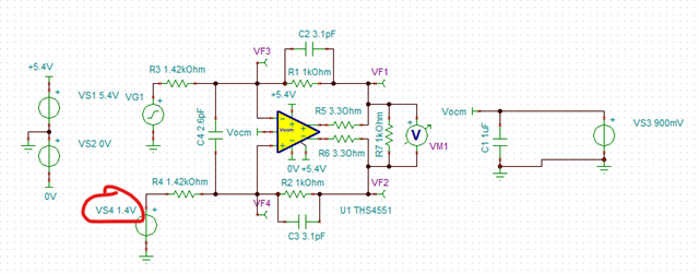

  • Check this simulation
    • FDA: THS4551.
    • ADC internal reference: 1 V.
    • ADC input: Differential.
    • AVDD = 1.8 V (generated from an LDO).
    • ADC VCM = AVDD/2 = 0.9 V, connected directly to the THS4551 VOCM pin.
    • THS4551 supply: Single supply, 5.4 V.
    Input Signal
    My input signal is single-ended:
    • Minimum = 0.2 V
    • Maximum = 2.8 V
    I want the THS4551 to convert this into the proper differential signal required by the AD9257.
    Simulation Issue
    I am simulating the circuit in TINA-TI.

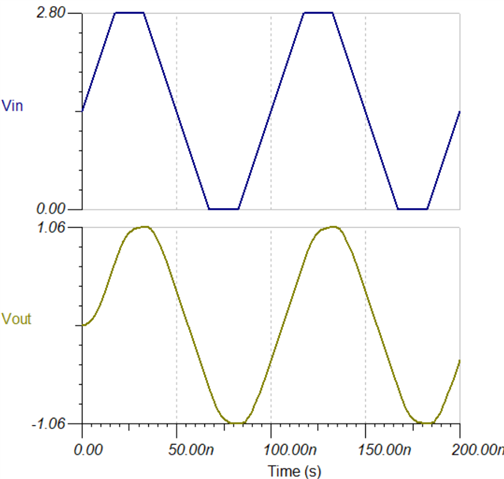

    When I apply a sine wave or square wave with:
    • Amplitude = 1.4 V
    • DC Offset = 1.4 V
    (the resulting signal swings from approximately 0 V to 2.8 V),
    I observe that:
    • The differential output is correct only up to around 0–1.8 V input.
    • Above this range, either OUT+ or OUT− starts clipping.
    • One output peaks while the other no longer swings symmetrically.
    • The differential output becomes distorted and is no longer correct.
    This appears to be output clipping.
    • Is the clipping caused by incorrect gain, incorrect common-mode voltage, or output swing limitations of the THS4551?
    • For a single-ended input, is it recommended to drive:
      • IN+
      • or IN−?
        Does one configuration provide better performance?
    • My ADC full-scale differential input is approximately 1.8 Vpp. What closed-loop gain should I use in the THS4551 for a 0.2 V to 2.8 V single-ended input?
    • What resistor values are recommended for the THS4551 in this application?
    • Is an output RC network required between the THS4551 and the ADC? If yes, what values are recommended for:
      • Series resistors
      • Differential capacitor
      • Any common-mode capacitors
    • Should I place a 1 kΩ resistor between OUT+ and OUT−, or should I only use the recommended RC filter?
    • If an anti-aliasing filter is recommended, would a Butterworth filter be the preferred choice? If so, what filter order and cutoff frequency would you recommend for a 30 MSPS sampling rate?
    • How should I perform stability analysis for the THS4551 in TINA-TI?
      • Should I perform loop-gain analysis?
      • What phase margin should I target?
      • How should I choose the compensation capacitors, if required?
    • Is a 5.4 V single supply the optimum supply for the THS4551 in this application, or would another supply voltage provide better performance?
    Any recommendations on the complete analog front-end—from the THS4551 output to the ADC input—including gain, filtering, stability, and recommended passive component values would be greatly appreciated.
    Add 3.3ohm in schematic simulation
  • I need output like -1 to 1V 2Vpp signal possible or not please tell me
  • Hi Nishant,
    There are a lot of questions here but I'll try to answer what I see as the major themes to start off.
    On the Simulation:
    • Your input signal is basically unipolar, only going +0V to +2.8V and back. So the outputs differentially only swing in one direction as well.
    • The THS4551 outputs can only swing about 200mV above Vs- (0V or ground in this case). The TINA Model captures this behavior.
    • Since Vocm is at 0.9V, and the outputs can only swing to 0.2V, each output can only swing about 700mV negative.
    • In the case for In- = 2.8V and In+ = 0V, the output has to swing 2V differential.
      • One output swings +1V and the other swings -1V from 0.9V common-mode
      • However the one that swings negative can only swing 0.7V negative. This leads to the massive asymmetry and weird results you are seeing in simulation.
    • The fix would be to add a voltage pedestal to the un-driven leg at 1.4V. This means the differential input will be +/-1.4V.
    • This allows the outputs to swing in both directions as well, bringing differential output back to 2Vpp.

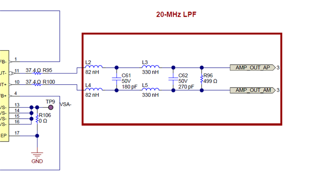

    • An Anti-aliasing filter is recommended. Probably some amount below your nyquist depending on what kind of signals you are measuring. For 30MSPS your nyquist is 15MHz so something slightly below that.
    • A lot of the THS4551 datasheet configurations show an active Multiple Feedback Filter (MFB) configuration. You can see this application note for information on that: https://www.ti.com/lit/ab/sdaa099a/sdaa099a.pdf though typically that filtering scheme is for slower ADCs and bandwidths in the kHz range.
    • You can either drive some passive RC filter, in which case you should make sure you can drive the appropriate cap load with the right isolation resistance.
    • Or you can use the circuit you have an tweak the values a little bit.
      • Your 1.4kohm will form an RC filter with your input capacitance.
      • You can tweak that input capacitance to get the filter bandwidth you want.
      • This will create a pole in your feedback that will effect stability. You can tweak your feedback capacitance to create a zero that will cancel that pole.
    • Here I estimated some values that gave me 10MHz bandwidth.
      • 10MHz with 1.4kohm Rg --> ~11pF input capacitors. 22pF differential.
      • 10MHz with 1kohm Rg --> ~16pF feedback capacitors. Usually I have the zero before the pole though to make sure its ok with variations.
      • This gave me a bandwidth of ~11MHz. Quick stability sim showed 60+ degrees phase margin. I would aim for at least 45 degrees.

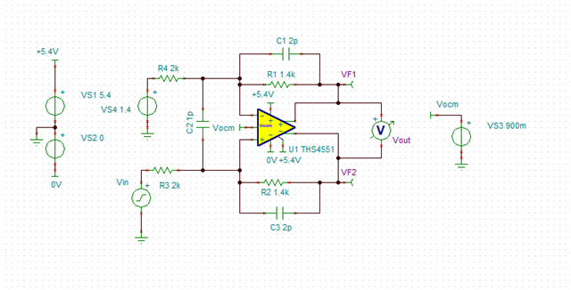

  • THS4551_1_Schematic.TSC
    I am using the THS4551 as a fully differential driver for the Pipeline ADC and would appreciate your guidance on a few observations from my simulation.
    System Details:
    • ADC Supply:
      • AVDD = 1.8 V
      • DRVDD = 1.8 V
    • ADC Input Range: 2 Vpp Differential
    • It is recommended that give input differential input to ADC not single ended input
    • ADC Common-Mode Voltage (VCM): 0.9 V (provided by the ADC)
    • ADC Internal Reference: 1 V
    • THS4551 Supply: 5.4 V
    • Input Signal: Single-ended square wave
    • Gain Configuration: 0.6 V/V
    Questions:
    1. With the gain configured to 0.6 V/V, I expect approximately 2 Vpp differential output, but the simulation shows only about 1.68 Vpp differential. Could you help identify the possible reason for this discrepancy?
    2. The waveform at one of the outputs (VF4) appears distorted even though the input is an ideal square wave. What could be causing this distortion? Is it due to slew rate, bandwidth, output loading, feedback network, or another factor?
    3. From a stability perspective, does the simulated response appear acceptable, or are there signs of instability that should be addressed?
    4. Since the ADC operates from a 1.8 V supply while the THS4551 is powered from 5.4 V:
      • Is it acceptable to operate the amplifier and ADC from different supply voltages?
      • Are there any reliability or interface concerns with this configuration?
    5. What is the minimum recommended supply voltage for the THS4551 while still achieving:
      • 2 Vpp differential output,
      • VCM = 0.9 V,
      • good linearity,
      • and stable operation?
    6. Can the THS4551 be powered directly from 1.8 V while driving the ADC with a 2 Vpp differential input? If not, what supply voltage would be recommend as the optimum choice considering performance, output swing, and design margin, stability?
    7.  Also tell is there any protection circuit recommended such that if Output of Amplifier goes above 2Vpp output clamps or there should be some safety margin for not blowing ADC. Please tell to get optimum SNR and Linearity in input what should I do as ADC should not have problem in driven. AVDD is 1.8V for ADC Absolute max rating of AVDD, DRVDD is -0.3V to 2V .
    8. Tell AIN+ &AIN- of ADC what it should be as input voltage range is 2Vpp differential input voltage mentioned
    Thanks.
  • Hi Nishant,
    1. With your 2.8V input differential X 0.6V/V gain = 1.68Vpp output. You'll need to increase your gain to ~0.714V/V to get the output to 2Vpp. There are a couple other things to note though:
      1. Your DC pedestal on In- is +2V, while your other input swings between 0V-->2.8V.
      2. On positive swings there is a 0.8V input differential. With the 0.6V/V gain the output swings 0.48V differentially.
      3. On negative swings there is a -2V differential. With the 0.6V/V gain the output swings 1.2V differentially.
      4. This combines for the 1.68Vpp differential.
      5. To make this symmetrical around 0.9V, the DC pedestal on In- should be 1.4V, or the mid point of how much your SE input swings.
    2. VF4 appears distorted because of the differences between how the In- and In+ legs are being driven. In+ is being driven by the source, while In- has to play catchup so-to-speak with the virtual short inputs. This is just an inherit property of driving an FDA SE to Differential.
    3. Stability wise it is a bit on the border with as an attenuator. With 0.6V/V signal gain its noise gain is 1.6V/V or ~4.08dB. There is a small resonance in the device's open-loop gain that degrades the phase margin here, I simulated that you have about 35 degrees.
      Attenuators can be tricky for FDAs as they often rely on the fact that a signal gain of 1V/V for them is really a noise gain of 2V/V which helps for stability. Having some extra feedback capacitors to bring the noise gain back up at higher frequencies when it crosses the AOL will bring the phase margin back up. See this attached file.
      6354.THS4551 Stability Eval.TSC

  • Hi Nishant,
    Apologies for the delay, I was out of office for a week.
    On the general design considerations:
    • Thanks for the extra information on your input signals. I forgot that we were looking at square waves earlier. A 10MHz square wave worst case would need more bandwidth than the 10MHz filter scheme I proposed earlier as an example. You'll have to tweak what I do as needed.
    • 80V/us on a 2.8V step --> 35ns rise time --> 0.35/35ns ~=10MHz at least required, however since it is a 10MHz square wave you'll want the harmonics to make a periodic edge clean.
    • 16pF + 22pF only has ~9MHz of bandwidth. After playing around with values, I found that only having 2pF in the feedback and 1pF in-between the inputs gave the cleanest response in the time domain, no gain peaking with 60 degrees phase margin.
      THS4551_newlynew_schematic.TSC
      THS4551 newlynew Stability Eval.TSC
    • It's worth noting that a 30MSPS ADC may not see a 10MHz square wave very cleanly. You'll may want to consider 10X the fundamental frequency for bandwidth so 100MSPS at least in this case. If you end up going that way, you may want to consider the THS4541 as an ADC driver instead which is luckily pin-to-pin compatible with the THS4551 in RGT package.
    On the board implementation and debug:
    • Probing IN+ and IN- pins directly is possible. However most probes introduce like ~10pF of capacitance which is going to change your results and stability conditions just from probing. It's ok to quickly double check things but just know your signals at that time will not look as good.
    • The 49.9ohm termination resistor could help you in your case since your signals are so fast, and it seems like you are using the coax cables and/or bringing different PCBs together. I would recommend a place holder before the Rg resistors to ground like R6/R7 below. With a 50ohm source you'll need to add a resistor the equivalent of the termination in parallel with 50ohms so ~25ohms.
    • With your 0ohm placeholders on the outputs, and the implementation of the FB pins, I think the schematic looks good other than the termination resistors on the Rg resistors.
    On the TINA questions:
    • I'm not able to replicate your issues with converging on your TINA files. They run fine for me and the results look ok.
      • It's worth noting on your piecewise linear inputs, your rise times are 10us >> 35ns needed for 80V/us.
    • THD isn't modeled in TINA unfortunately.

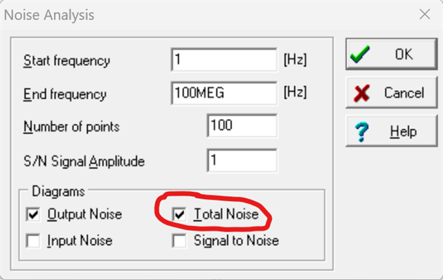

    • For noise, you can get the total integrated noise at each frequency by checking the Total Noise checkbox when running a noise analysis.
    • Gain margin can be looked at the same time as phase margin.
    • The THS4551 model was made before we started accurately adding Zo so the output loading doesn't affect the model much.
    • A manual break is better for stability analysis.

    For filtering a lot of the time for pipeline ADCs its something like this scheme used for the ADC3910D125 EVM. A passive LC LPF.
    You may want to try without the filter and adjust your sample rate to see your system bandwidth limitations before implementing a filter to tune in your bandwidths and help with noise/aliasing.
    Best of luck with your testing!

  • Hi Nishant,
    If a DC offset is added to your SE input signal, then adding that same offset to your undriven leg would be the best way to remove it I would think. The amplifier should differentially subtract that DC offset with its differential gain.
    For example here if you have 1.4V DC offset on Vin then adding that 1.4V to the undriven leg will subtract it out:
    There could be a few ways to implement this depending on what your signal source is.
    How much offset do you need to calibrate out?
    Evan

  • Hi Nishant,
    To generate that DC offset I think this scheme would work: https://www.ti.com/lit/an/sbaa343a/sbaa343a.pdf
    It could run on the same 5/5.4V supply you have, it uses a DAC and precision amp to create that DC offset.
    V-OFFSET in this diagram should be applied to the other input of the FDA as I drew in the above post.
    It uses DAC80504 and offers OPA227 or OPA188 as devices. I think each of those look good.
    Evan
  • New_Schematic_FDA.TSCNew_Stability_Gain.TSC
    Please check whether the stability, noise, and settling-time analysis of the amplifier is correct. I have attached the detailed questions and relevant information in the “Stability” section of the schematic for reference.
  • Hi Nishant,
    The new circuit looks pretty close to the previous and looks good on the stability front.
    Based on the previously mentioned 80V/us for 2.8V step, the FDA circuit has about 40MHz of bandwidth which I think is sufficient. However I would recommend your ADC sampling rate to be increased. For 80V/us and 2.8V step the rise time is about 35ns. 15MSPS has a sample window of 66ns. I would recommend increasing this to the 40-65MSPS that your ADC can handle. 40MSPS gets to 25ns and 65MSPS is around 15ns so that will have more points per edge.
    Evan
  • Hello TI Team,
    I am using the THS4551 in the RGT package with a 5-V supply and would like to confirm the correct simulation and PCB implementation methodology.
    I have the following questions:
    1. The RGT package has approximately 0.6-pF internal feedback capacitors and approximately 1.2-pF differential input capacitance. Since these internal capacitances are not included in the TINA-TI model, should I add any external feedback or input capacitors for setting the bandwidth and improving stability, or should I first evaluate the design using only the internal capacitances? In simulation and hardware what expected result i get?
    2. The datasheet mentions that the TINA-TI model does not include the RGT package's internal 3.3-Ω resistance between OUT and FB. For an accurate RGT package simulation, should I add an external 3.3-Ω resistor between OUT+ and FB+ and another 3.3-Ω resistor between OUT− and FB− in the TINA-TI simulation?
    3. On my PCB, I have placed a header connector directly at OUT+ and OUT− for measurement/probing, Since the RGT package already has the internal 3.3-Ω connection between OUT and FB, is this PCB arrangement acceptable from a stability and high-frequency layout perspective? Or probing (passive probes of oscilloscope) at both output terminal will have capacitance issue and gain and offset error?
    4. Please do by simulation not comments (measurement stability) and extra provision in PCB to smooth testing
    5. Should the OUT+ and OUT− header/probing connection be considered in the stability simulation through its associated parasitic capacitance and inductance?
    6. For the feedback network, should the feedback capacitor be placed externally at all, or is the internal 0.6-pF feedback capacitor sufficient for my required bandwidth and stability?
    7. If an external feedback capacitor is required, what is the recommended method for selecting its value based on my required closed-loop bandwidth, noise gain, phase margin, and settling time?
    8. For the open-loop gain/phase and stability analysis, the datasheet shows a simulation methodology involving cancellation of the internal 0.6-pF feedback capacitance. Should I follow this methodology for calculating the phase margin and gain margin?
    9. For the final closed-loop simulation, should I use the normal THS4551 TINA-TI model with the internal 0.6-pF feedback capacitors included, while separately adding the RGT package's 3.3-Ω OUT-to-FB resistance?
    10. Should I include the complete functional block in the final simulation, including the THS4551, feedback network, input network, output RC filter, ADC input capacitance/loading, header/connector parasitics, and PCB parasitics, in order to obtain a realistic result?
    11. If I include all these elements, can the resulting simulation be used to reliably determine the total system bandwidth, phase margin, gain margin, noise, settling time, required attenuation, and output-swing limitation?
    12. Since my amplifier supply is now 5 V, what is the recommended simulation methodology for determining the maximum allowable OUT+ and OUT− swing while maintaining adequate linearity and stability (both in Hardware and simulation)?
    13. For my application, should the ADC input network and its loading be included in the loop/stability analysis, or should stability first be verified with the THS4551 feedback network alone and the ADC interface evaluated separately?
    14. Finally, what would TI recommend as the best-fit TINA-TI simulation setup for the THS4551 RGT package so that the simulated bandwidth, phase margin, gain margin, noise, settling time, attenuation, and output swing most closely represent the actual hardware?
  • Hi Nishant,
    The 0.6pF and 1.2pF input capacitors are included in the TINA model. The only thing not included are the internal 3.3ohm resistors. Which you could add as series resistors to your feedback resistors but I don't think it'll change the stability conditions too much. It might even be within the % error of the feedback resistors.
    The header will add some capacitance due to layout and whatever is attached. Simulating it would be ideal, something like 10pF could capture it depending on your scope probe or what it is used for. Probing with an oscilloscope will load your circuit and could change offsets and such so its typically something more for debug.
    I would simulate stability without the ADC and its network, then add it in.

  • Hi Nishant,
    If the scope probe is <12pF, then using like 15pF in simulation with the addition of the header would be fine. Having a little isolation resistance (10-50ohms) to your header or test point can go a long way to not disturb the amplifier during testing.
    Are you asking why have the external feedback capacitors and capacitor between the inputs if there are the internal capacitances? In your case, even though the capacitors are on the same general magnitude as the internal capacitors, it does seem to increase your phase margin by about 25 degrees, which also reduces your gain peaking it looks like.
    It's pretty common to have these kinds of capacitors at least as provisions. It's common to try and make the ADC driver into an active filter and the feedback capacitors will do that, but you need the capacitor between the inputs to compensate for stability.
    In your case when you are using the FDA as an attenuator, FDAs like this are often far less stable as an attenuator. They often rely on at least a gain of one, or a noise gain of two for the amplifier. Putting it as an attenuator is more like a noise gain of one. Having these kind of compensation capacitors will shape the noise gain to something higher is common for FDAs as attenuators. It seems to me like the internal capacitors of the THS4551 were likely put there for this purpose.
    Evan
  • Hello TI Team,
    My current configuration is:
    Supply voltage 5V Single ended
    • Rf = 1.4 kΩ
    • Rg = 2 kΩ
    • Closed-loop gain ≈ 1+Rf/Rg= 1.7 V/V (4.6 dB)
    • Feedback capacitor as shown in the attached schematic
    • Output RC filter and ADC load are also included.
    I would appreciate your guidance on the following:
    1. Is the Rf/Rg configuration and feedback capacitor appropriate for my required bandwidth and stability?
    2. Is my TINA-TI stability analysis methodology correct for the THS4551?
    3. What phase margin and gain margin should I target for this application? Is ≥60° phase margin a suitable target?
    4. For accurate stability analysis, should I include the complete feedback network, output RC filter, ADC input/load, VOCM network, and parasitic in TINA-TI?
    5. Is the feedback-loop break point in my TINA-TI simulation correctly selected for measuring loop gain, phase margin, and gain margin?
    6. What changes should I expect in phase margin, gain margin, bandwidth, peaking, settling, and stability with and without the feedback capacitor?
    7. If the current stability margin is insufficient, which parameter should be optimized first: feedback capacitor, input/noise-gain compensation capacitor, series output resistor, or Rf/Rg?
    8. Can the attached TINA-TI results be considered representative of the actual hardware, and are there any additional PCB-level stability checks you recommend?
    9. Attached Output swing of each output of driver in the stability simulation spice
    My objective is to ensure stable operation of the complete THS4551 + ADC interface and good correlation between TINA-TI simulation and hardware measurements.
    I have attached the complete schematic and TINA-TI simulation .Is there in analysis in TINA using split supplies -2.5V and 2.5V and only 5V single supply have any impact on analysis or same Stability_FDA.TSC
    Thank you.
  • Hello TI team,
    As I wanted to put termination resistor provision in the input so that for eg 220k or 200k input not given by 50 ohm source so that resistor from Input tied to gnd or Vcm on both input terminals as I don't want my Vcm to alter from 0.9 V . So what is the best way and if I don't give input to FDA generally asking and only given supply of 5 V to FDA as there are not 1 FDA is there many 7-8 FDA are in the system so termination Resistor is Best. If input given to one FDA and other inputs are floating and supply is given for that also otherwise output will oscillates?? If I am wrong please correct
  • Hi Nishant,
    I don't see the RC filter and ADC loading in that file you attached. What filter scheme are you using?
    To answer your other questions:
    • The circuit configuration and stability analysis method are correct.
    • Phase margin looks like ~62 degrees as is. 60+ is definitely a suitable target, even 45 I would be comfortable with.
    • Removing the feedback capacitor network brings phase margin down to 37 degrees.
    • Adding say 15pF of cap load from your header configuration is lowering your phase margin by quite a lot. Is that header in series with your ADC? Is it just for debugging?
    Header/Scope Probe Loading:
    Having some series resistance is the easiest way to improve the capacitive loading. It would need to be 50ohms at least from my simulations to get the phase margin back to ~50 degrees.
    Header/Scope Probe Loading with Riso:
    This would mean you would need some series resistance to the headers. Even some 0ohm placeholders would be recommended.
    If this header is just for debug then just knowing that probing with an oscilloscope will give you more overshoot and such when probing is ok. If you at least know that then you know your circuit isn't broken or anything while debugging.
    If that header is in series with your ADC, then that series resistance will need to be part of your RC filter or not interfere with whatever is down the line. Often people don't like adding the series resistance on the output like that. In that case, increasing your noise gain with your feedback capacitor network is your next best tool. However, looks like it will need to be a pretty heavy compensation without any Riso. This will also lower your bandwidth.
    This compensation looks ok but lowers your signal bandwidth from 44MHz down to 2.7MHz which won't be sufficient for your bandwidth requirements.
    Header/Scope Probe Loading with Cap Compensation:
    Possibly a combination of the two could get you there.
    Evan
  • Hello TI Team,Stability_2_FDA.TSC
    Attached is the equivalent circuit showing the amplifier output, filter, test headers, and ADC connection. The headers allow us to verify the THS4551 output swing independently before connecting the ADC through the jumper link.
    For the unused THS4551 inputs when only one of the 7–8 FDAs are driven, should I provide a high-value termination resistor (e.g., 200–220 kΩ) to GND or VCM to prevent floating inputs and possible oscillation, while keeping VCM = 0.9 V stable? What is the recommended termination approach? or no need of termination is needed? .That termination resistor changes my gain target values as my actual analog input voltage source doesn't carry 50-ohm source impedance. But currently for testing by function generator.
    And how you calculate 44Mhz
  • Hi Nishant,
    I'm getting 44MHz looking at the bandwidth at Vout with this circuit.
    Stability looks good with the ADC circuit attached. Sounds like the headers are just used for evaluation then.
    I don't think termination resistors are needed while the input resistors are floating. The capacitor between the inputs should be the one to help the most with stability. With the inputs floating the Vocm should still set the output common-mode to 0.9V which will then be applied to the input-pins of the amplifier when the input resistors are left floating. My only concern would be how the connection is being reapplied, as the floating input resistors will also be at 0.9V at that point.
    200kohm is a lot, I wonder how you settled on that value. The 50ohm impedance/termination resistor we have on our EVMs or evaluation circuits is more for bench equipment with long cables often being used.
    Evan
