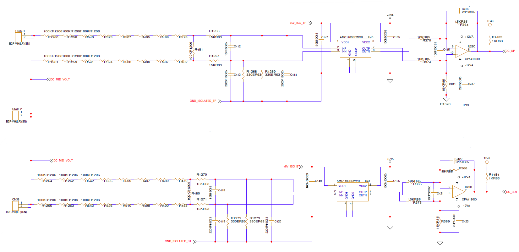

  • We are using AMC1100 devices to measure two DC bus mid-point voltages in our system. Both measurement channels use the same circuit configuration (attached schematic).
    When the DC bus is balanced, both mid-point voltages should have the same value. Most of the time, the measurements are correct. However, we occasionally observe a difference between the two measured voltages, even though the actual DC bus voltages are equal and stable
    The offset appears randomly and is not consistently repeatable. We have not identified any specific operating condition that triggers it.

    Where is the random offset observed and what is it's behavior once present? Does it remain static, oscillate or ramp?
    In general, the differential to SE conversion OPA should have the same power supplies as the low side supply of the AMC1100. These +/-12V supplies could be creating a return current loop from the 5VA supply.

  • Hi Alexendar,
    We think the noise is coming through the DC bus as common-mode noise. Can we make any changes to the circuit to reduce this common-mode noise, and possibly the differential-mode noise as well?
    Without the layout or pictures of the offset, it's difficult for me to make too many recommendations.
    The common-mode noise rejection of the AMC1100 is quite high, so I doubt this is the issue, but it will be largely layout dependent. If the noise is common-mode noise resulting from layout, then this is a system level issue that should be addressed and understood. Moving the channel that has the issues away from the source of the issue in layout is a practical solution to consider.
