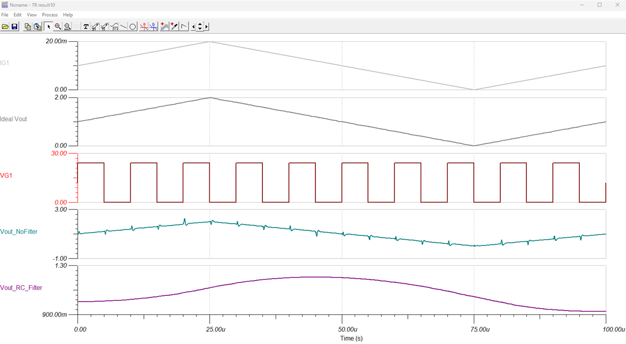

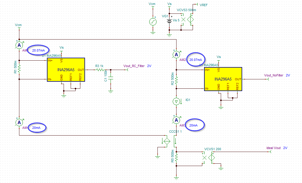

    If you are getting average and you do not need 50uA error then the INA296 could work.  If you do not need high bandwidth as you mentioned the RC filter at the output then we have other alternatives but the VCM transition is the biggest issue. I need to know the voltage switching in my model I did 0-24V.  I need to know this to give you another alterative if you require better than 50µA error.
    Here is an example of where the error can come from in a Tina simulation.  First DC error with 20mA.  You can see the difference before and after the the INA296 is 70µA.  This number is typical and can vary about ~40µA.  It is IB * 2.  The TINA simulation uses 35µA *2 (one for each input pin)
    Also you can use the RC filter but you will have a delay in the signal.  So for the switching if you need measurements in the range of your switching.  For DC measurements the RC filter will help and give you low error.  For currents that are changing like a 10kHz triangle wave you will get a large error.
    Below you can see the nofilter has the spikes from the VCM transitions in the no filtered output but looks closer to the ideal output.  The RC filtered output is lower and will give you an average but will not look like the ideal output.

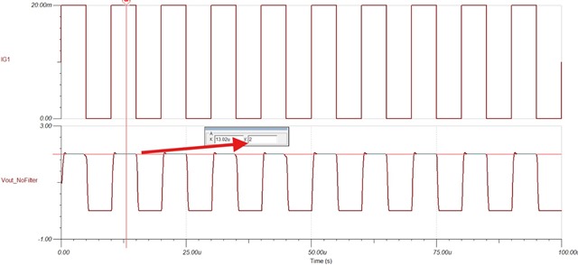

    I can see the 35uA*2 both in my simulation and your simulation, but I don't have any error in the INA output after stabilization, it's perfectly stand on 2V.
    Is that make sense? What am I missing here?
    NOTE that I use the INA with VCM=1VDC, also no transients at all in the common mode voltage!
    IN addition, the current waveform is rectangle in 100kHz running between 20mA and 0mA.
    See below snapshot of IG1 and the Vout_NoFilter waveforms.

    The error I thought I saw required is 50µA.  If this is the max then this could work.  The error is more like 35µA but this value will vary like stated in the datasheet.  The reason is both pins pull on average 35µA *2.  The following is assuming a device is used with 35µA.  The current you attempting to measure is normally too low if measuring  the power supply current  in the example above it is 20.07mA and the output is measuring 20.035mA.  If you are attempting to measure the load current it would measure 20mA but the output would measure 20.035mA.
    The simulation we showed did not have enough digits on the output.  I have shared another screen shot.
  • ok I see in your screen an error of 45uA. good enough for me I guess. Thanks Javier.
