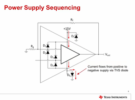

We have recently designed a V-to-I converter for our 3-wire transmitter using the INA592, OPA2196, and TMUX6219.
We are observing a back-powering issue when the loop wire is connected to ground (Source Mode) while the device ground supply is disconnected. Under this condition, the device appears to be powering through an unintended path.
The current through the R142 and R59 is almost same as like 4-20mA loop current but the current showing in the ammeter which is connected between Loop wire and Power supply GND is equal to total current consuming by the device.V to I Converter.pdf
I have attached the schematic.
  • Hi Doudu,
    In order for the device to work as expected, the negative supply needs to stay connected to a potential or else current will run through internal paths as you have demonstrated. We have a series of videos covering electrical overstress in our op amps, and in the video titled "Electrical overstress - introduction," power supply sequencing is covered.
    Usually a TVS diode on the negative supply connected to ground would help this issue, but depending on the way in which the ground is disconnected, this might not be possible.
    Is the condition where the ground supply becomes disconnected required for some safety requirements? Is the ground only being disconnected from the V- pin of the INA592?

  • Hi Doudu,
    Sorry for the delay here, I was out-of-office yesterday. I see, I will have to think about how we could fix this issue, as it would likely require different buffer amps. We do have the OPA310, which does include fail-safe input ESDs that prevent back powering, but this is a low voltage part that wouldn't work with a supply voltage of 33V.
    I will reach out to see if we have any high voltage parts with the same feature and get back to you.
