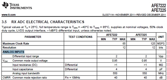

    •  However the MAX2829 which is the source for this OP-AMP has Output resistance requirements of 10 kohm minimum . LMH6551 is defined for    G = +1, VS = 3.3V, VCM = 1.65V, RF = RG = 365Ω, RL = 500Ω . What is the input AC resistance of the AFE7222/5 ?

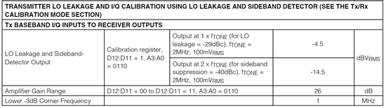

    From what I can gather about the MAX2829:
    • You are talking about using a FDA on the "LO leakage and sideband-detector outputs" which have a 10k ohm minimum differential impedance requirement at 1MHz bandwidth! High speed paths usually are not 10k impedance levels!
    • The BW is limited to 1MHz

    May be a device like the LMP8350 with 480kohm input impedance, as shown below, is more appropriate for what you need (since the bandwidth is rather low).
    Here is the AFE7222 Analog input definition showing an input capacitance of 4pF:
