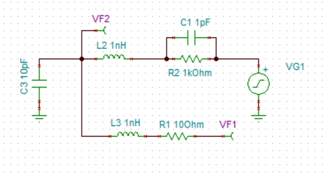

    Good question. On paper the Riso you've shown from the OPA855 datasheet should do the same thing in that it should dampen any L/C resonance and has the benefit of being inside the feedback such that it doesn't create a voltage drop from the APD current.
    However in my experience and in simulation it doesn't work as well to dampen any resonance. You can see here in simulation that there is still some notch in the NG.
    Removing the device from the equation could make things more clear. The Riso will isolate resonances from the In- pin but from the output Rf will need to isolate the resonance instead. However it is shorted-out in high frequency because of the Cf.
    Note that since VF1 (In-) goes into high-impedance it will overlap with VF2.
    Feedback Network with Cf:
    Feedback Network without Cf:
    Unfortunately you need some Cf to keep the device stable with any input capacitance.
