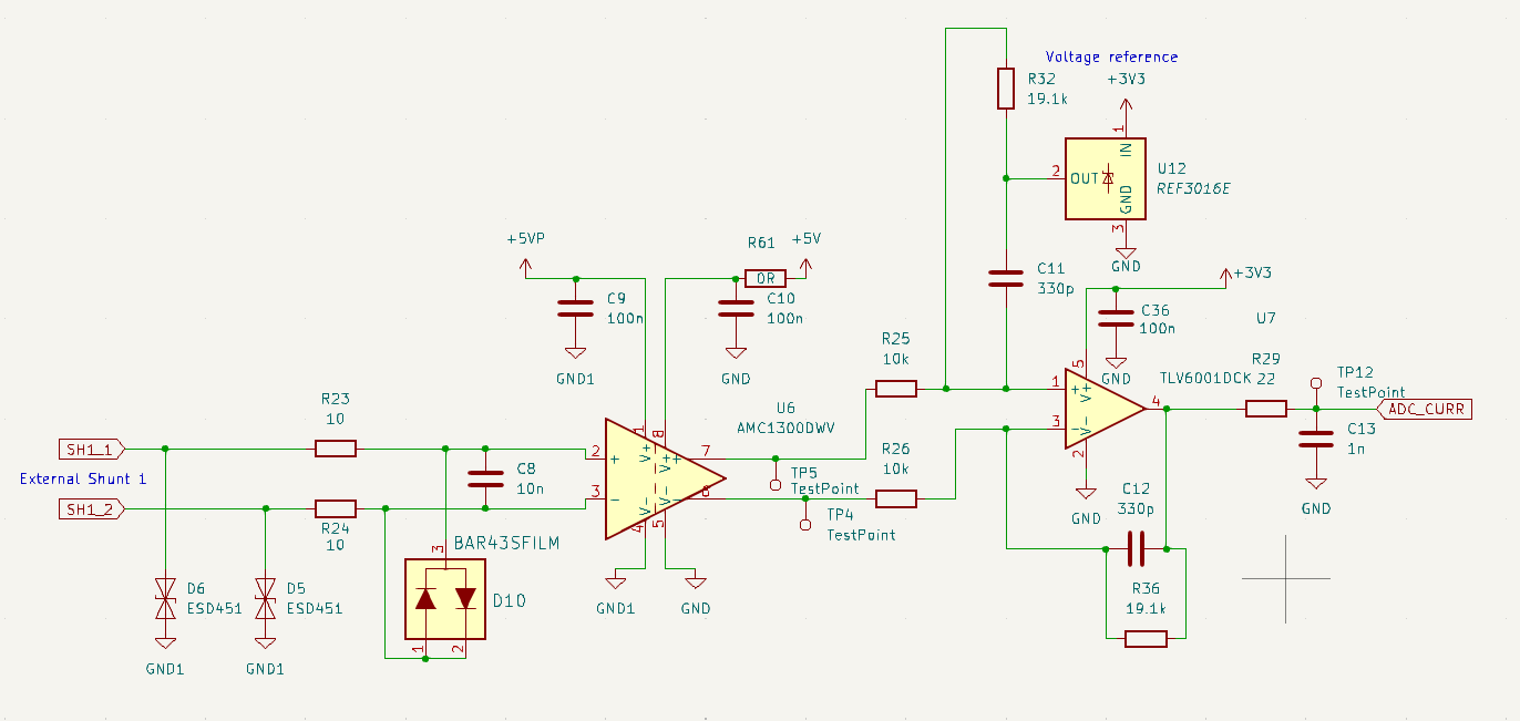

As I cannot commnet anymore on this thread: https://e2e.ti.com/support/amplifiers-group/amplifiers/f/amplifiers-forum/1658493/tlv6001-tlv6001-differential-amplifier-issue
I'm opening now new becasue after redesign it still doesn't work as expected.
I've added 1.65 voltage reference as suggested in original post but I still cannot get full range and when no current is flowing I'm getting on output 1.426V which is not right also (should be 1.65V).
This is actual design:
Is there anything else I'm missing please? Thanks.
