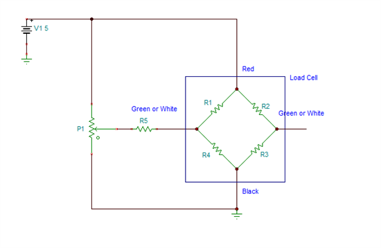

    All bridge type sensors have some amount of offset without any force applied due to slight mismatches in the internal resistances of the sensor. You can see this by applying a voltage to the bridge sensor and measuring the no-load voltage output from the sensor with a voltmeter. My, now retired, colleague Bruce Trump and I addressed this issue in this thead: http://e2e.ti.com/support/amplifiers/precision_amplifiers/f/14/p/223084/785468.aspx#785468
    Essentially you can apply a voltage to null the bridge offset at zero load without losing ADC range.

  • The variable resistor would be connected to the load cell like this:

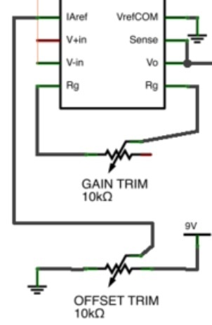

    I should also state that if the V- supply of the INA125 is ground/0V then the output of the INA125 will only be able to output a minimum voltage of .4V:
    To output 0V with this part, you will require a negative supply voltage.
  • Now it's clear for me, thanks
    What about this scheme that use IAref?
  • Increasing the voltage at IAREF will prevent the output of the INA125 from saturating at the negative rail. The compromise is that you will be losing output range. For example, if V(IAREF) = 1V, then the INA125 will output voltages from 1V to VCC, if this compromise is acceptable in your system then it is a reasonable solution.

  • Sergio,
    The connection diagram in my post is correct, one input of the INA125 would connect to the right of R5, the other input would connect to the other load cell output. R5 is absolutely essential for this schematic to work.
