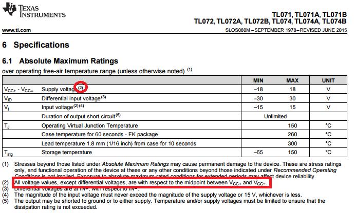

Request you to please confirm
Vccpos – Vccneg rating mentioned in the Maximum rating section of new datasheet has range of -18v to 18v
but the old datasheet mentions VCC+ to be 18v max and VCC- to be -18v min
what is the maximum & minimum value VCC_positive supply can take ?
what is the maximum & minimum value VCC_negative supply can take ?

  • Siddharth,
    There is no internal ground pin inside the op amps, including TL07xx, thus the power supply voltages can be anything you want as long as the total power supply voltage between positive (V+) and negative supply (V-) does NOT exceed 36V.  Therefore, they could be +18V & -18V, 0V & 36V, -36V & 0V, or 100V & 136V, etc.  Of course, if you shift the power supplies you have to make sure that the input and output voltages stay within your supplies - see link below for more information.

  • thanks do you mean VCC_POSITIVE - VCC_NEGATIVE should at maximum be 36v ? So then why is the figure 18v indicated under the Max column? Also what is the minimum value that the expression VCC_POSITIVE - VCC_NEGATIVE can take? regards
  • Siddharth,
    Yes, the total supply voltage is VCC_POSITIVE - VCC_NEGATIVE or  (V+)-(V-) in case of TL07xx must be less than 36V.
    Please read the note (2) above:  All voltages are with respect to the midpoint between Vcc+ and Vcc-.  Thus max +18V is with respect to the midpoint whatever it might be; if supplies happen to be 100V & 136V, the midpoint is 118V and thus MAX supply can be 18V above it (118V+18=136) and MIN supply 18 V below it (118V-18V=100V).
    The Absolute Minimum value for the total supply voltage is 0V (you should never reverse supplies-this prevents damaging the part) but specified minimum value for TL07xx total supply voltage (for the circuit to work properly) is +/-9V - see below:
