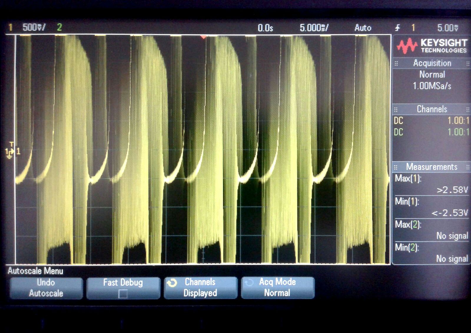

I understand the howland pump a little better now. I have developed the following circuit. it is working fine in simulation, but works terribly when I built it on bread board. can you suggest a solution?
the screen shot with clear sine signal is when I connect a 1.1 ohm resistor as load, the other screen shot is when I connect toroid transformer (287.5uH + .5 ohm) as load. I need a clear sine signal as in simulation. Any ideas on how to fix this?
