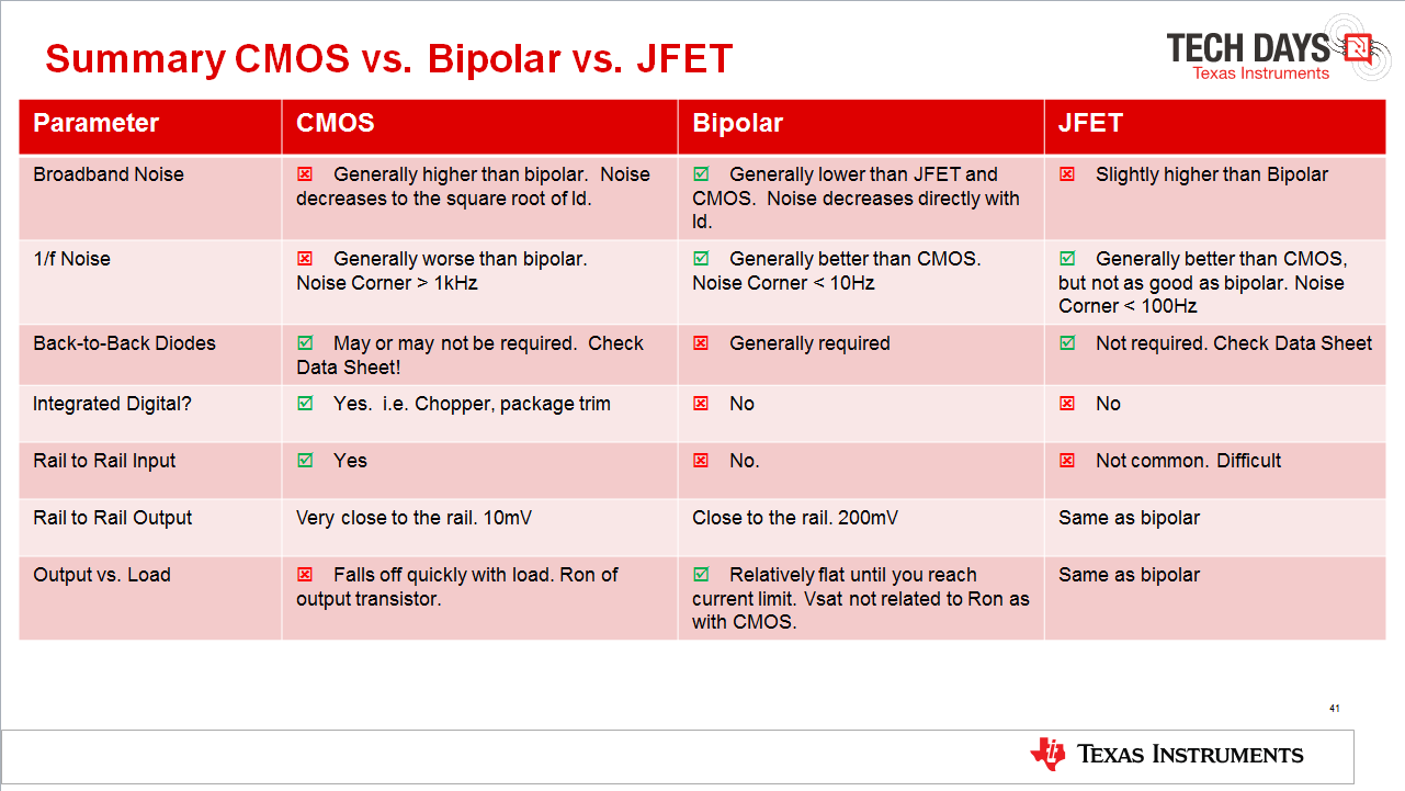

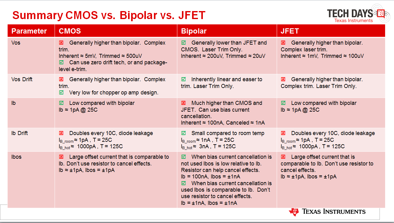

I have a general question on JFET input op amps.
What are the main disadvantages or limitations to JFET opamps for precision applications?
Hi Timothy,
For higher voltage op amp applications using supplies such as +/-6 V to +/-18 V, JFET input op amps can offer better parametric performances compared to their bipolar, and CMOS counterparts. It just depends on the particular ones of interest. One characteristic of JFET circuits is they tend to require higher internal operating voltages than their bipolar and CMOS counterparts. For that reason the availability of low-voltage, high-performance JFET input op amps is somewhat limited. That might be a drawback in some cases.
We have an op amp technology session that we present during some TI Tech Days. There are some tables in the session materials where general comparisons of op amp parameters are made for CMOS, bipolar,and JFET op amps. I've copied the tables below and hopefully they provide the information you need. Note the green check and red "x" boxes.
If you have specific parameter questions let us know.
Regards, Thomas
Precision Amplifiers Applications Engineering
