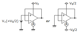

  • Tachibana-san,
    You may NOT connect op amp in an open-loop configuration (no feedback) as shown on your circuit schematic because shorting the inputs will result in the internal input offset voltage being gained up by the open- loop gain thus forcing the output to one of the rails where datasheet condition of Vout=Vs/2 will NOT be satisfied.
    To measure IQ, place the op amp in buffer (follower) configuration, by shorting output to inverting (negative) input, while driving the non-inverting (positive) input to mid-supply.  The easiest way to accomplish this configuration is by using the dual +/-2.75V supplies and grounding the input.  You may then determine IQ by either placing an amp-meter or small (100ohm) resistor,  in series with positive or nagative supply pins and use amp-meter or volt-meter, respectively, to take the measurement. Since there should be no output current, Iout, under quiescent condition, there is no need to include RL in IQ measurement (it makes no difference).
  • Hello Lis-san,
    Thanks for your advice.
    According to your explanation, measurement circuit for quiescent current is as follows, isn't it?
    Are the specified values in the datasheet also measured with those circuit?
    And when I would like to measure the quiescent current under the following condition,
    should I apply Vs/2+1.3V (=3.75V) at V+ terminal in the left circuit?
    "TA = 25°C, IO = 0, VS = 5.5 V, VCM < (V+ ) – 1.3 V"
    Please let me confirm to be sure.
    M. Tachibana
  • Tachibana-san,
    Your IQ measurement circuit configurations as shown above are correct and we measure IQ in production in a very similar way.
    Having said that, as long as your input common-mode and the output voltage are within the OPA376 linear range (see CMRR and AOL condition column), the quiescent current will be the same.
