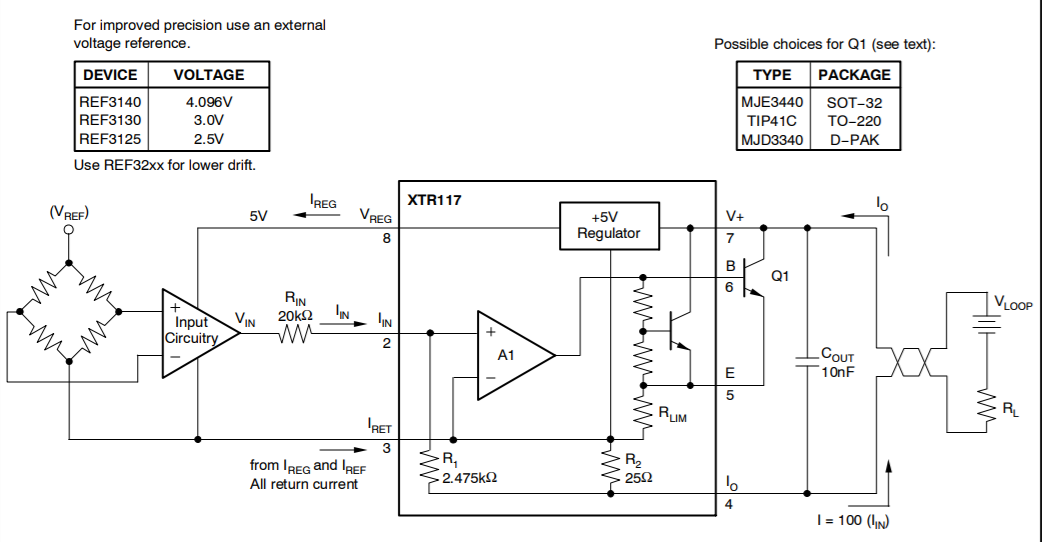

I want to use XTR 117 for 4 to 20 mA transmitter, But my Input to the XTR117 is resistance bacause I want to transmit how much % valve position is open.Valve position is in the form of resirtor.Please guide me and give some circuit design link so it will be easy for me.
