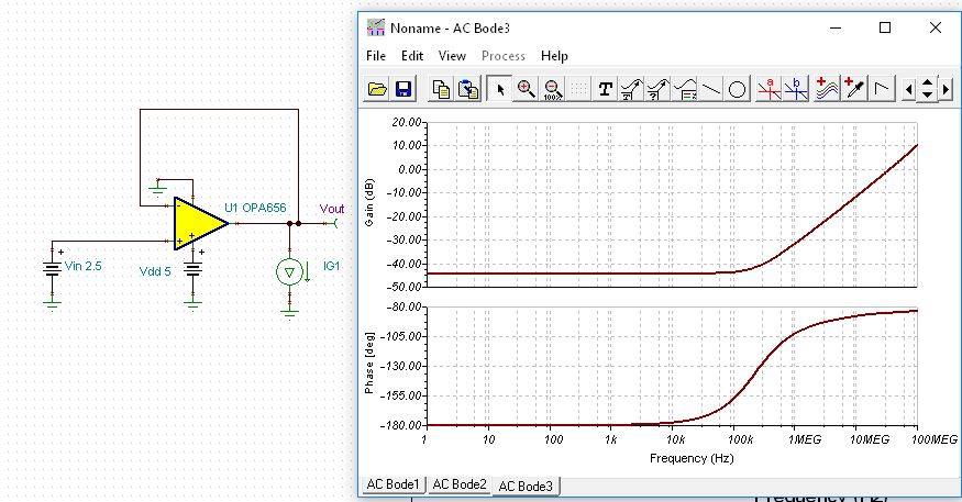

Customer reported the transient waveform of OPA656 simultation model looks strange, for both TINA and Pspice.
I double checked the AOL and Zo vs Freq, it indeed looks different than datasheet shown, I guess both models need small fix.
, correct me if I am wrong, thanks.
Andrew

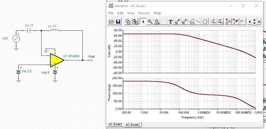

Hi Sean,
Customer showed me the difference of transient waveform from TINA and Pspice model as below.
They looks different to me. Just wondering, which one I should suggest customer to use for their circuit simulation?
Thanks for the feedback, I found my Zo plot has problem. Thanks for sharing.
Andrew
Hi Andrew,
Download the latest model from the OPA656 Tool & Software webpage.
Sean
Hi Sean,
Sorry for confuse, I was using December 2016 models from the beginning, that is the model I felt not accurate enough, the AOL roll off is not very matching datasheet if we look closely, comparing to other precision TINA model, this one is not perfect match.
Andrew
