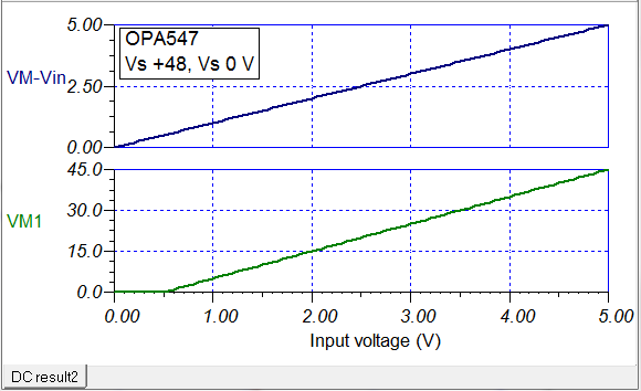

Hi Jeremy,
If you change V- from -5 V to 0 V, you have to make sure you observe the OPA547/OPA548 linear input common-mode voltage range (Vcm), and output voltage swing range on the low end. If violated, the circuit won't perform as needed.
The current limit accuracy is specified under only condition in the OPA547/OPA548 Electrical Characteristics table. The max error under that condition is about +/-10 %, but under other conditions it may be higher. I tested the OPA548 model with the current limit set to various from about 30 mA to 100 mA and found that the current where the current limit kicked in was off by 10 mA, and sometimes more. The current limit function is not intended to be a precise current limit, but more so a general limit used to protect a load or the op amp.
It is possible for the OPA547/OPA548 output voltage to drop below 0 V in a simulation because of the ideal current source connected to the output. You can see this in my version of TINA simulation circuit shown below. In a real circuit that wouldn't be the case unless the current source could support the reversal.

Hi Jeremy,
It looks like the reduction in components didn't actually make any difference.
Okay, then the input bias current (Ib) of the OPA547 you are testing must be towards the low end. I mentioned it because it might be an issue with a different production run of OPA547 that just happen to have higher Ib.
I think you might be comparing the new value (-0.8V) to the output of the initial circuit that has V- connected to -12V rather than GND (-12V or so). Let me know if I'm wrong about that or if you were able to see a difference by scaling the components by a factor of 10 (maybe I missed something).
That -0.8 V would only come about in simulation because the ideal current source can accommodate the polarity switch. The actual circuit with a real load wouldn't be able to support a negative output voltage when a single, positive supply is being applied. Simulation shows that with a resistive load (1 k) connected from the output to ground the minimum output voltage is about +0.75 V and +45 V, for a +48/0V supply arrangement. The output doesn't go negative as expected.
