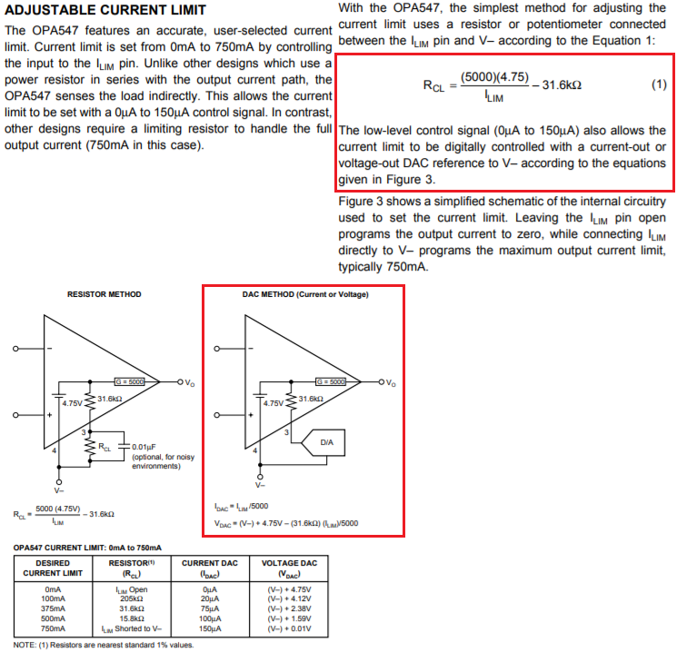

DAC method to control current limit is shown in Figure 3 (p.9 of the datasheet), see the capture image below.
If V- is 0V or GND, then Vdac = 0 +4.75V - 31.6kOhm*I_lim/5000.
For instance, I_limit=375mA, Vdac = 4.75V - 31.6kOhm*0.375/5000 = 2.38V, which it matches the figure in the label above.
I_limit=250mA, Vdac = 4.75 - 31.6kOhm*0.250/5000 = 3.17V, assume V- = 0 or GND
I_limit=21mA, Vdac = 4.75 - 31.6kOhm*0.021/5000 = 4.617V, assume V- = 0 or GND

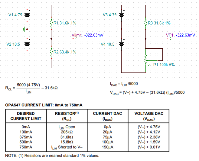

Hi Vysakh,
Here is how it is calculated.
(5V - (-10.5V))/(R1 + R2 +R3) = (Vlim - (-10.5V))/R3, where R2 + R3 = 100kOhm
15.5V/104.99k = (3.17V + 10.5)/R3 and calculate R3 = 92.594kOhm, see the attached simulation. (The current flow from 5V to -10.5V are identical and apply Ohm's law).

Hi Raymond,
I have already tried these equation. But there is an internal resistor (31.6k) and a 4.75V source inside the OP-AMP ILIM pin which is coming into picture for the calculation. So, I separately simulated that with LTspice simulator and found that the above calculation is getting affected by the internal resistor (31.6k) and a 4.75V source. Please find the LT spice simulated circuitry below:
As per the above diagram, the R1 & V1 is the OPA547 internal 4.75 voltage source and 31.6k resistor and R3 & R4 is acting as the 100k digital potentiometer and the ILIM marked point is the OPA547 current limit pin. As shown in the figure, the calculation suggested by you is matching only if the internal 31.6k resistor connection is disconnected from the ILIM pin. The values are getting changed when the OPA547 internal 4.75 voltage source and 31.6k resistor are connected.
Calculation example:
R3 calculated with 250mA current limit (With the above calculation):
(5V - (-10.5V)/(R1 + R2 +R3) = (Vlim - (-10.5V)/R3, where R2 + R3 = 100kOhm & R1 + R2 + R3 = 104.99kOhm
R3 = (3.17 * 104.99) / 15.5 = 21.47k
As per the above calculation, a 21.47k resistor value should be set to achieve the 250mA current limit. But the Tina-Ti simulation shows that the 250mA can be achieved with a 17.3k resistor value. This difference is occurring because of the OPA547 internal circuitry effect.

I see your problems are. You need to connect the potentiometer directly to pin3 as the diagram is shown on the resistor method. Or you use DAC method. 4.75Vdc is internal to OPA547. Can you connect in the following manner?
We still have to the following equation. With resistor divider method, Rcl is calculated to be 5000*4.75/0.25 - 31.6kOhm = 63.4kOhm.
