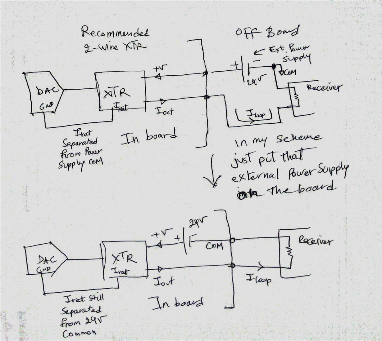

In most documents found that the XTR115/6/7 devices are suitable for 2-wire passive current loop with seprate remote power outside of the transmitters.

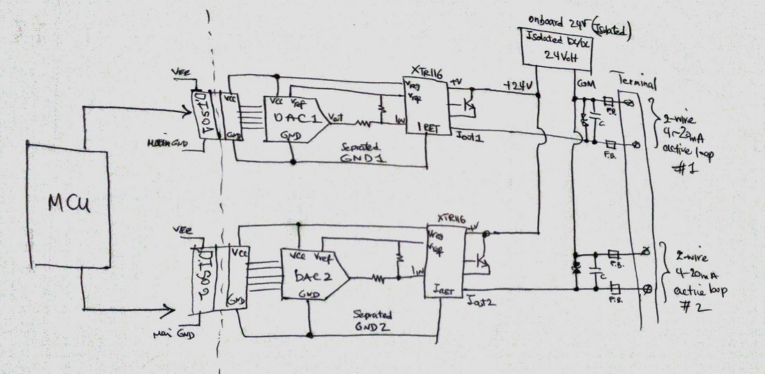

my issue is designing a 2 channel, 2 wire 4 to 20mA active transmitter using XTR116.
Is this schematic proper for my issue?
I highly appreciated to having your recommendations.
