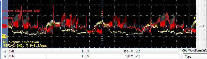

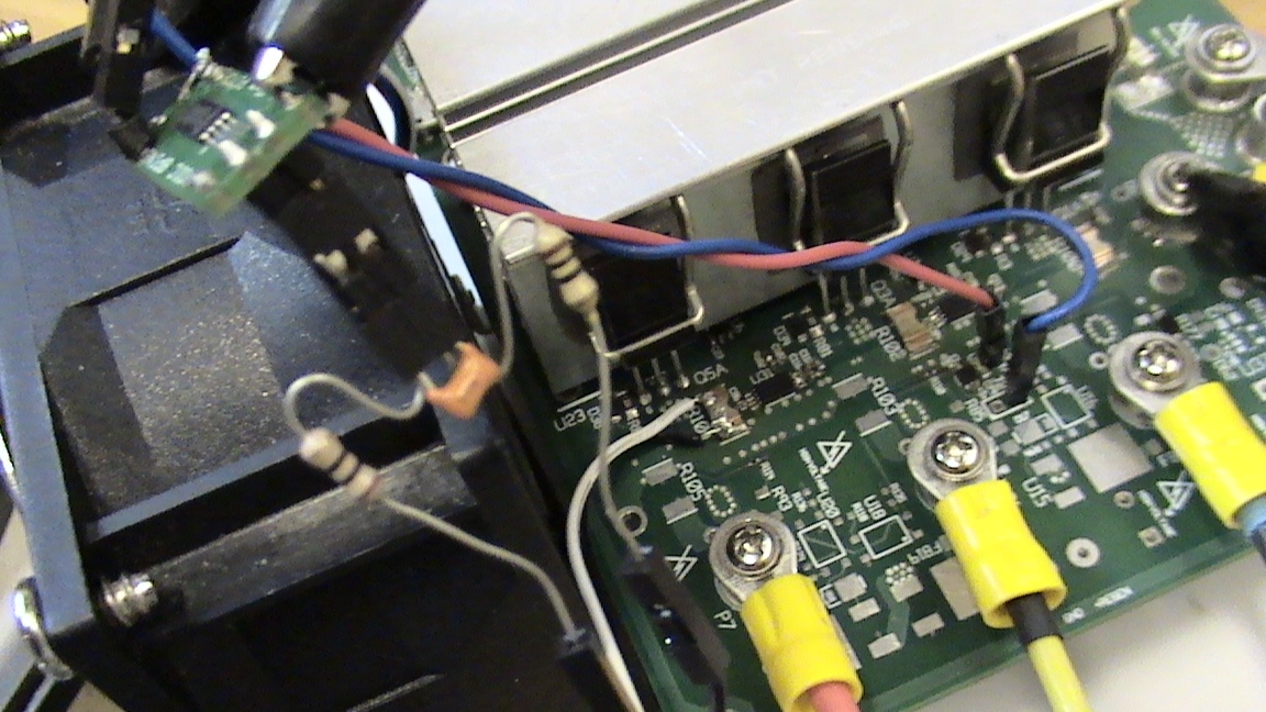

    Definitely is not producing 20mv @2amps and A2 in photo was closer to 190mv over REF for REF/2 or VS/2 (1.65v) @7.9-8.2 amps. That is an average peak, not peak! Will be testing A1 on the same Jiffy PCB (photo), input filter 10ohm + 100nf. Filter makes negative CMV invert above REF in random phase shifted pulses, no output filtering. Jiffy PCB has 6.8uf polymer electrolytic 0.1uf filtering +3v3 and not to far from 3v3 LDO (red wire) wrapped (blue) via digital GND, not analog GND.

    The previous thread last test of the three A1 on motor PCB has REF1+2=GND via 49R9/100n filter (each A1), REF roughly 30mV above ground. Yet the output signal pulsed near 1v9 peaks, almost 1/3 full scale @8amps phase current even with 4K87 divider each A1 output. Far more than X20 gain was being produced by A1 output. Potentiometer rule confirms the output divider should  keep signal well below 200mv. Tina transient analysis plots have no indication of increased amplifier current gain result of CMRR being 95db @12.5kHz PWM.
    Our motor PCB circuit for A1 should be roughly 120mV-30mv REF output @8 amps phase current, not 1v9 especially after output division. Seemingly the shunt CMV leaks pulse voltage directly into A1 output increasing *20 gain via -CMRR creepage. Perhaps little to no EMI shielding in the 240 allows shunt crossing high frequency RF to increase amplifier current gain past any datasheet stated gains (A1,A2,A3,A4). Either way any improvement in A1,A2 precision is seemingly out of the question until the 240 architecture has been corrected to stop PWM creepage or shunt -CMRR migration into output signal. This behavior of 240 is a game stopper!
    Have discovered as reported above, EMI/RFI creepage or PWM intrusion of stated -CMRR (+95db @12.5kHz) is reduced when 240 located away from CMV of (shunt main PCB). Proximity of shunt answers why 240 placed vertical (jiffy PCB) to that of shunt orientation reduces almost removes all PWM intrusion (EMI/RFI) on A1/A2 output effecting open loop gain of any 240 mounted parallel (planar) on main PCB plane.
    This output gain issue manifested obviously from lack of internal case shielding 240 amplifier. Hence there is a proximity ratio of CMRR based on shunt location to +/-IN pins not being disclosed in datasheet. This proximity issue obviously escaping any laboratory updates to datasheet is troubling to say the least. Forum guru post 8 months ago "TI was sending 240 out for EMI shield testing." Results of EMI  testing has never been disclosed to public, forum discussion or Wiki updates as it should have been. Now we think Numetal covers are required to stop excessive open loop gain of shunt crossing -CMRR being exposed on A1 output via EMI?
    Vertical mounting 240 above or locating package a specific proximity away from shunt PWM source reduces effect of planar EMI from attacking amplifier open loop gain. Where is that seemingly and relative fact being disclosed in 240 datasheet? Are we to just take these sour licks and like it or should TI investigate why or how EMI is so effecting datasheet culpability? We think they should step up to the plate and expeditiously rectify this issue ASAP for all 240 devices or at least manufacture a replacement 240 with full internal Numetal shielding!
