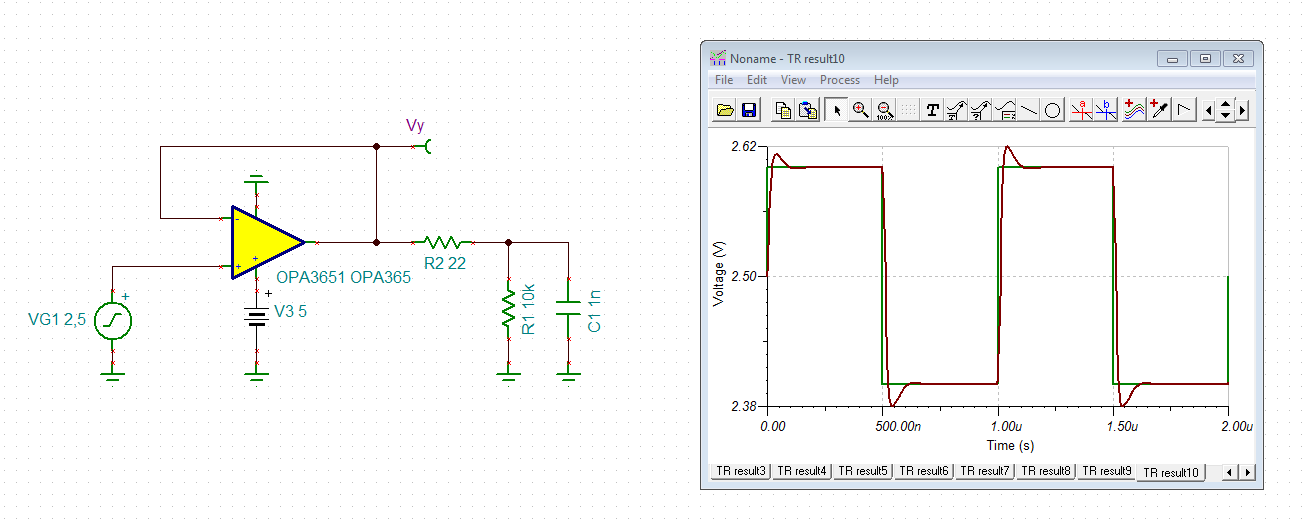

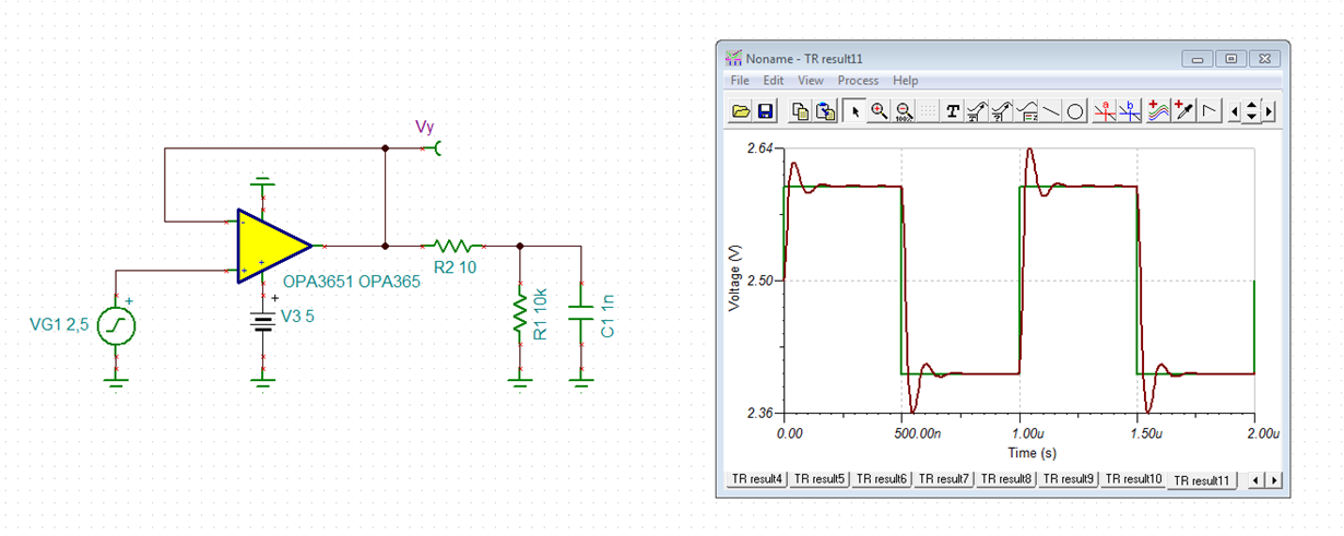

I simulated OPA365's phase margin with driving capacitive load (1nF) by TINA-TI.
But the phase margin was not so good. I know that we should have over 45 degree margin.
Please check following file that TINA result and TINA project file.
OPA365Q1 phase margin_result.pdf
OPA365Q1 phase margin project.TSC
Could you teach me how to think about phase margin and how to control phase margin with driving capacitive load?
I referred to '9.1.1 Capacitive Loads' at data sheet, so I added series resistor at output line.
Now, I plan to input signal from hundreds [kHz] to several [MHz].
