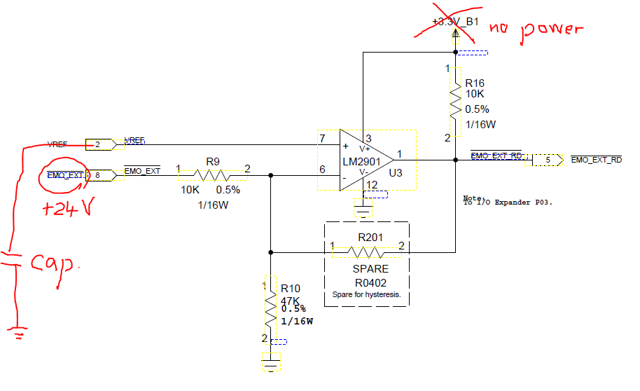

LM2901: Burn out when VCC not supplied, +ve input connects to capacitor and -ve input connects to 24 V
Part Number: LM2901
This part is not biasing/supplied by any power rails at all.
The +ve input (pin 7) is connected to the capacitor, while the -ve input (pin 6) is connected to 24 V across resistor.
The capacitor then get burnt out with smoke, followed by this part package body near +ve input get damaged too.
Removing the part from the board with observation that the +ve input pad is also get split off.
Wondering that is it too much current flow into -ve pin that breaks down the internal transistor (which isolates -ve & +ve pins?) and causing the current flows to +ve pins?
Thanks.

    can you show a schematic?

    You should be able to bring the inputs up to 36V regardless of the supply voltage (even zero) without damage. However, if there is a negative glitch that brings any pin briefly below ground, this could trigger a destructive latch-up. The LM2901 family does NOT like negative input voltages.
    What is the voltage on VREF? How is the VREF voltage generated? Is it also at 0V?
    A capacitor "smoking" is very unusual. Is it a ceramic or Tantalum? What is the value? Does it blow right away? Or take a few seconds/minutes? Is the board supply current higher than expected?
    Tantalums can blow-up violently if the voltage is reversed - so check your polarity (is it in backwards?). They usually start getting warm first by drawing excessive current (10's-100's mA) when reversed - then blow when they have had enough. Same for Electrolytic, but with messier results.
    A ceramic (or other non-polarized) capacitor "smoking" would require a voltage applied greatly exceeding the working voltage, or a large high-frequency AC voltage applied.
    Have you watched the inputs and supply with a scope during turn-on/off? It sounds like there is a negative voltage on the VREF line - that is the only thing I can think of that would cause a tantalum capacitor to "smoke" and also severely damage the input.
