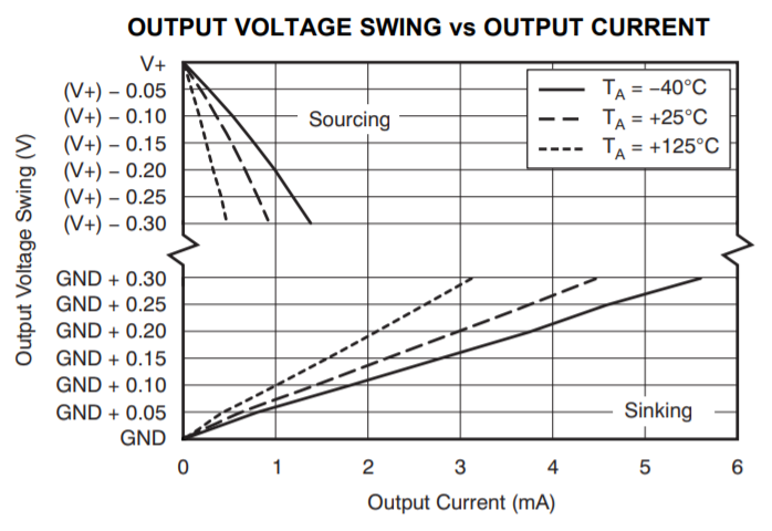

  • Hello user463911,
    I ran my own test on the INA216A1 as shown below.  Yellow is the input voltage to Vin+, blue is the voltage at Vin-, and pink is the voltage at the output all referred to ground.  I do see that the output is 5x greater than than what the expected output should be.  However, that peak decays in roughly 125us.  As such, I suspect you are below the recommended operating range (1.8V) for close to the duration of this surge you are talking about.  In this particular region, we do not have any data on the device functionality with respect to the drive strength and cannot make any guarantees in this operating region.  However, within the recommended operating region we have the data shown in the second figure below.
    As for startup output transient, you can reduce this output voltage peak by loading the output with a resistor.  With 500 ohms on the output I was able to get the output peak below 1V.
