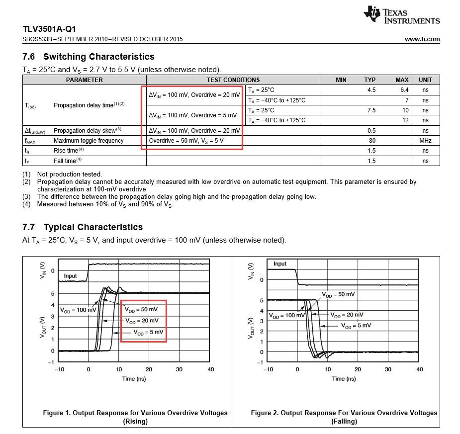

  • Hello Jankel,
    "Overdrive" is amount of voltage *above* the reference voltage.
    The delta-Vin is the total p-p voltage if the input signal.
    So, assuming VREF is 0V (gnd)
    For dVin=100mV, and Voverdrive=20mV, the input signal would be -80mV to +20mV
    For dVin=100mV, and Voverdrive=5mV, the input signal would be -95mV to +5mV
    For dVin=100mV, and Voverdrive=50mV, the input signal would be -50mV to +50mV

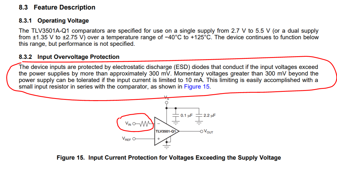

    And there're still some other questions:
    1, If the inverting terminal equals constant 5mV, and noninverting terminal will only be 0V or 10mV in my application (switching freq. between 0mV and 10mV is 300kHz), it's also possible for such a low input voltage level operation, right? (power rail is 5V/0V)
    2, What's the meaning of the wake-up delay in page7 of the TLV3501A-Q1 datasheet?
    3, Pls see the circuit below, if Vin equals 15V, power rail is 5V/0V, the only one resistor is 10k ohm, so the input current is of course smaller than 10mA, and I know from the datasheet that in this condition it seems the inverting terminal will be clamped to 5V by the ESD diode inside the opamp, right? But I got the simulation result of 15V at the inverting terminal in TINA-TI..............

    if your input signal is only +/-5mV, then you must consider the input offset voltage of TLV3501 of +/-6.5mV. So, it can be, that the TLV3501 is not working properly. I would increase the input signal amplitude: And, as the TLV3501 is very fast, I would provide some hysteresis too.
    The wake-up delay has to do with the shutdown feature. Read section 8.4.1 of datasheet and see figure 8.
    TINA-TI simulation usually works for operating within the specified common mode input voltage range. So, when the input signal exceeds the supply rails this might not be simulated correctly.
    Kai

  • Hi Jankel,
    If the input is +10mV and -10mV around the reference voltage, you have a 10mV overdrive, which according to the front page will give you a response time of 6-7ns.
    However, the TLV3501 has built-in 6mV hysteresis, with a ±6.5mV maximum offset, so the maximum thresholds would ±6.5mV + ±3mV, or ±9.5mV - so you are right on the edge of detection.
    As Kai said - try to get as much signal into the input as possible. The "harder" you drive the input, the faster it will respond.
