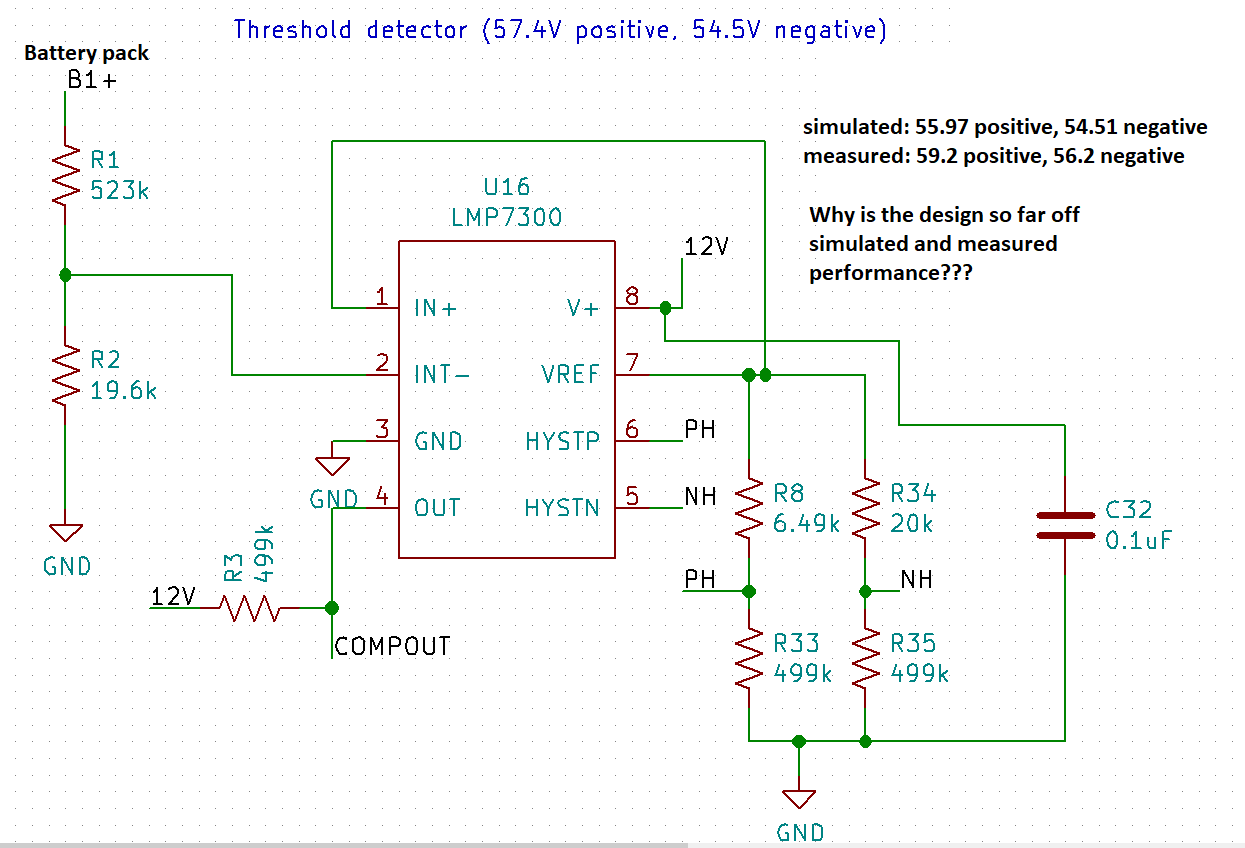

LMP7300: Measurements/Simulations do not match Design Equations
Part Number: LMP7300
Other Parts Discussed in Thread: TLV6700
The design requirements are simple:  Detect when the battery pack reaches 57.4V to shutoff the charger (positive going).  Then, detect when the battery pack discharges to 54.5V to turn on the charger (negative going).
See attached schematic/notes.
I've followed the design equations correctly as far as I can tell.
But unfortunately my simulation and measured results are way off.  What am I missing?  This should be such an easy design... argh..
Thanks for any help,
Erik
