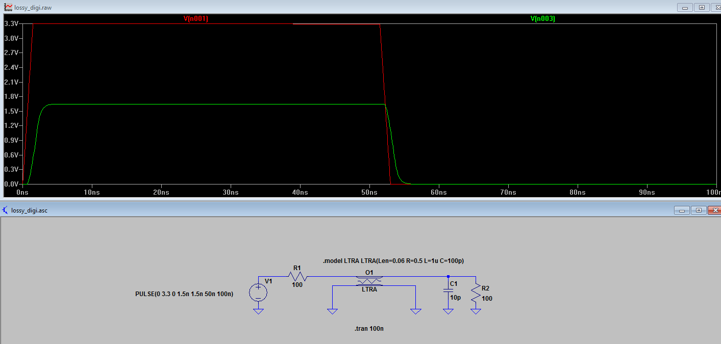

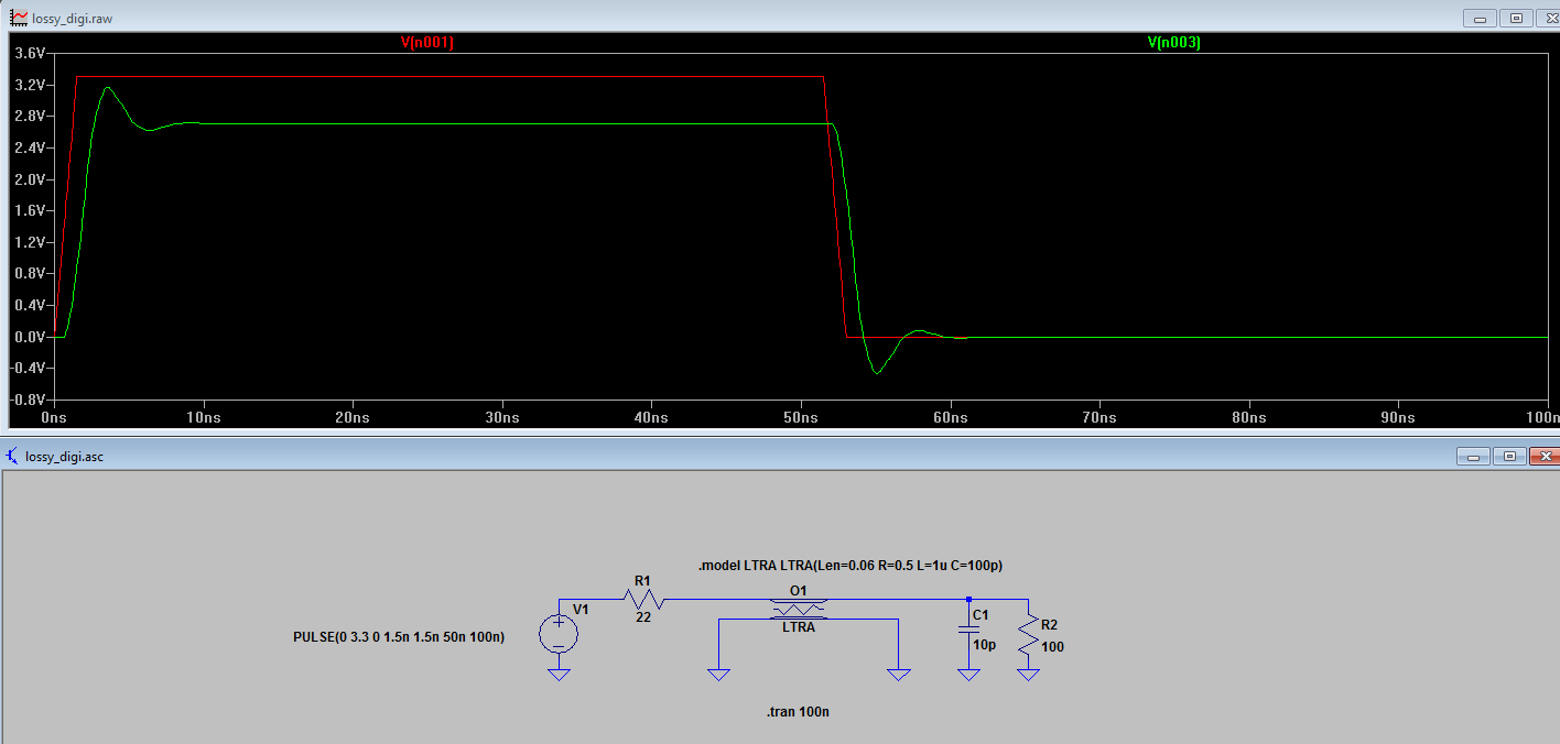

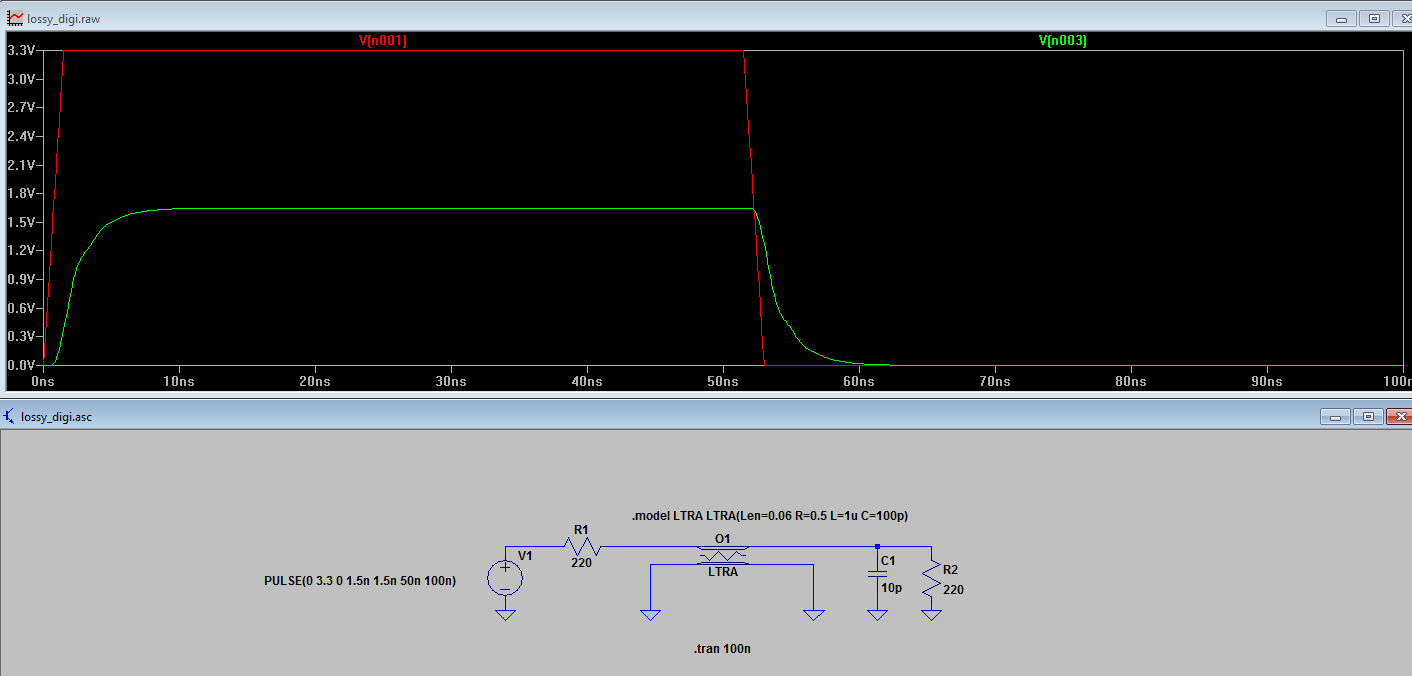

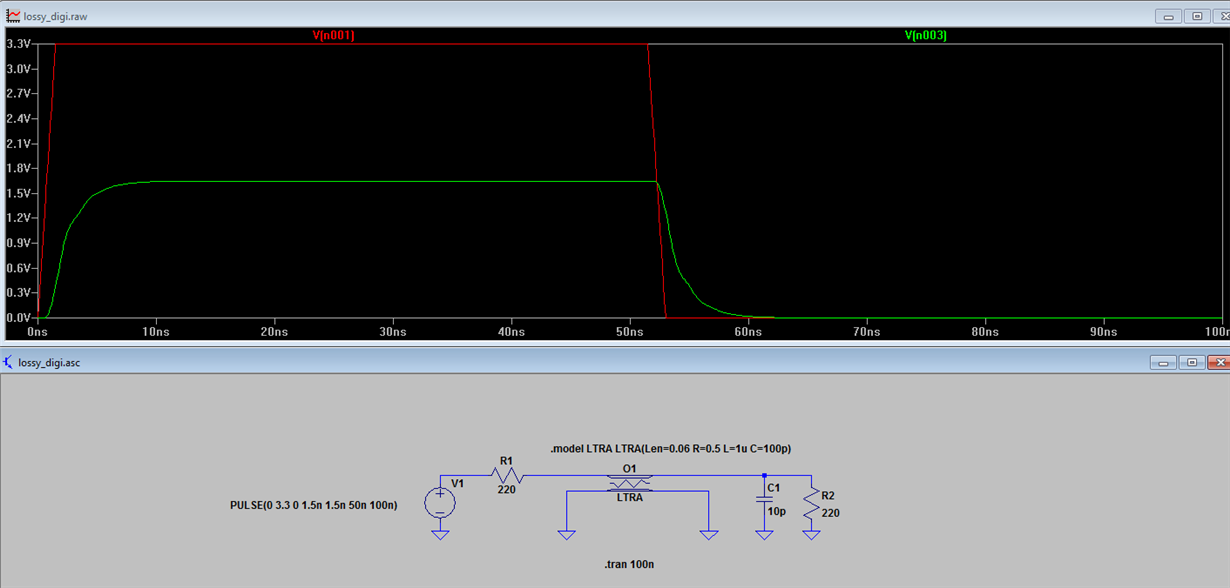

Hi Yatao,
yes, theory of characteristic impedance macthing says that the signal is exactly halved when using termination at both ends of the transmission line.
In the following you can see a simulation of the step response when driving a transmission line properly and improperly:
In all these simulations a transmission line of 100R and 60mm length is assumed. The source resistance of the voltage generator is zero and the rise and fall times are 1.5ns. (But keep in mind that the TLV3502 has a source resistance of about 50R.) The 10pF capacitance is the assumed input capacitance of FPGA.
Of course, these simulations are an idealization of what is actually going on in your circuit. But they show that R2 can be omitted, eventually. In any case make the series termination resistance (50R source resistance of TLV3502 plus R1) equal to the characteristic impedance of transmission line. When you increase the series termination resistance, the whole thing looks more like a low pass filter and when you decrease the series termination resistance, on the other hand, you will suffer from ringing. Ringing should be avoided, because it can turn-on the protection diodes at the input of FPGA and can cause lots of trouble.
