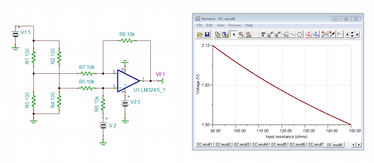

  • Hi Ankur,
    I think the way you amplify the bridge signal is unsuited. You would need an offset to handle the cases "PT100<100R" and "PT100>100R".
    Kai
  • Sorry Sir,
    didnt get the offset thing,
    does that means, i have to use some other opamp or any other values in my wheatstone setup?
    Please if you could explain, would be great help, sir.
  • ankur.TSC
    R3 runs from 90R to 150R in the simulation.
    You should rework your circuit.
    Kai

  • Hi Ankur,
    when using a PT100 element you must limit the measuring current to 1mA. Otherwise you will have too much self heating. This means that the correct way to drive a PT100 element is to use 1mA constant current and not a constant bridge voltage.
    Have you thought about using the XTR105? This current transmitter supports the use of PT100 and provides constant current sources of 800µA.
    Kai
