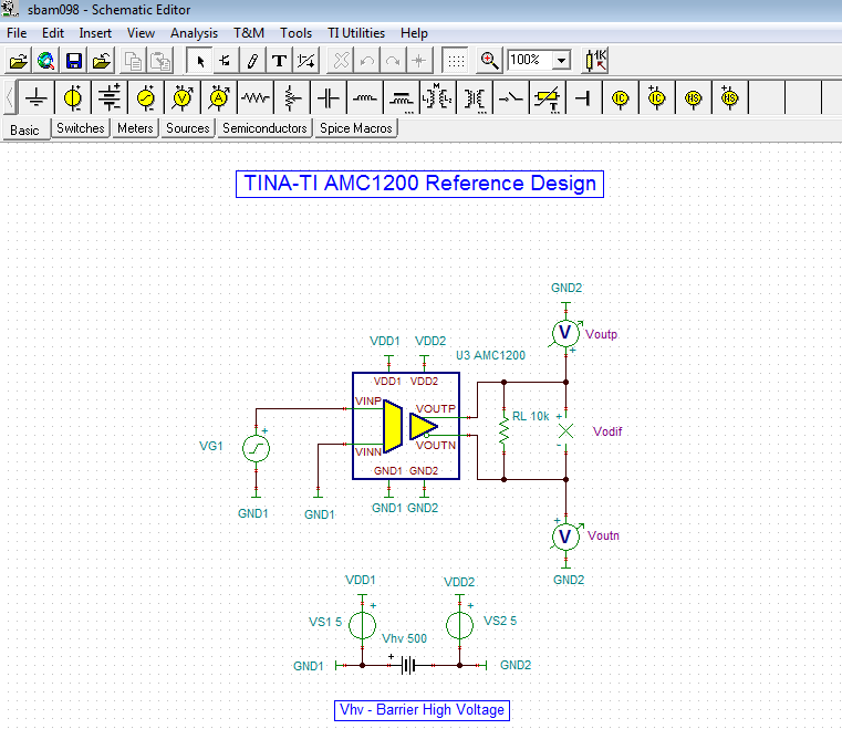

  • Hi Rajasekaran,
    why not running the "AMC1200 TINA-TI reference design"?
    Kai

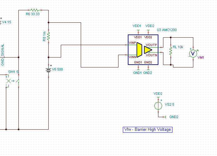

    we can able to run AMC1200 TINA TI model.
    We need to simulate ISO5852S and AMC1200 in the same circuit. If we try both in the same circuit, its not running properly. we are getting constant 4.95V as output (from AMC1200).
    Could you please suggest me the suitable procedure for running two isolated components in the same circuit.

  • Hi Rajasekaran,
    I modified the TSC file and I am getting the output voltage ~500mV. I removed the GND1 jumper from input and now input to AMC1200 is given like shown below.
    I have attached the TSC file and simulation results below. It seems that AMC1200 is amplifying input voltage.
    Please let me know if you have any questions.
