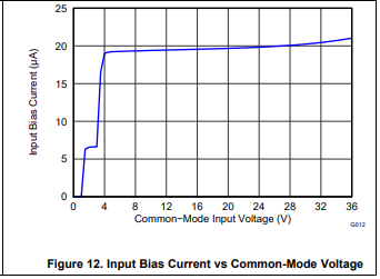

    Thanks for considering to use Texas Instruments.  According to electrical characteristics table, the typical current you might expect at your inputs which will be drawn across your 10 ohm filter resistors is 10uA.  The builk of this current can likely be attributed to an internal VCM detection circuit that adjusts internal rails for various circuit stages when the common mode voltage exceeds the device supply voltage.  When the VCM exceeds VCC, this internal circuit pulls more current from the input pins as shown in figure 12 of the datasheet.  As for the impedance to the ADC, we do not specify that.  However, as it is a delta-sigma ADC, I expect a buffer stage near the front and therefore a high-impedance.  I will check with our design engineers and see if I can provide you with a value on Monday.

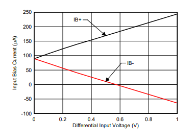

    In some of our newer devices we include IB vs Vsense plot such as in the example below (from INA240 datasheet).  However, older devices like the INA226 typically do not have them even though they have similar behavior.  In the second plot (from INA226 datasheet) you can see that once the common mode exceeds the supply voltage, the input bias current remains relatively unchanged.  This bump in bias comes from some circuitry that taps off from the bus to supply internal stages of the device.  This circuitry and what lies downstream can be equated to a current sink that is at some lower potential than your IN+ and IN-, the 139kohm corresponds to the impedance between the inputs and this sink.
    As for the error from mismatch, the resistor mismatch creates an offset that can increase the differential potential the ADC sees. In a simple case, we assume you have 1% resistors with the IN+ being 10.1ohm and the IN- being 9.9ohm. As vsense increases, IB+ rises and and IB- falls. If IB+=11uA and IB-=9uA. Then you will get an additional offset from these resistors equal to (10.1ohm*11uA)-(9.9ohm*9uA)=22uV. The error from this would then be 22uV/Vsense*100.
  • Hello Sebastion,

    Is there a way to estimate max difference between IB+ and IB - just looking at graph 12 (for INA226) ? I would like to estimate max error I can expect.

    As for the difference between IB+ and IB- you could take the 3.3 V point on the graph 12, roughly 7uA. Divide this by two to get 3.5uA for both IB+ and IB- when vsense is zero. Then as the common mode is the average of IN+ and IN-, half of your vsense differential should be seen between IN+ and the previously mentioned sink. With a resistance of 139k, the IB+ current should increase by (Vsense/2)/139K, while the IB- should decrease by the equivalent amount.

  • Hello Sebastian,
    Yes at common mode voltage different than the table's of 12V you will see a different input bias current.  In the case of a 3.3V common mode it will be around 3.5uA.  When I measured on my board I got about 2.5uA.  With respect to that, there was a detail that was overlooked before and I have since found that the impedance between an IN pin and the sink is closer to 6.25kohm.  If you are interested, I am attaching excel document in which I measured Ib with respect to Vsense.
