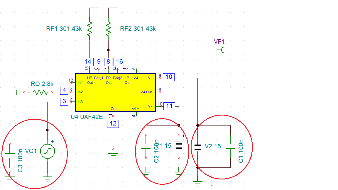

May I substitute UAF42AUE4 for the UAF42E in the Diagram, please?

    UAF42 has two different IC packages, namely UAF42AUE4 (SOIC-16 or U package) and P package (UAF42AP in PDIP-14). They are the same die, but pin 2 and pin 15 in UAF42AUE4 (SOIC-16) are NOT Connected or used.
    In the Tina model UAF42E, where "E" refers to enhanced Tina model. I am not sure what you are asking. In Tina's model, UAF42AUE4 and UAF42E are identical. If UAF42AUE4 is used in schematic drawing, please make sure that you follow the pin description prescribed in the UAF42 datasheet.

  • Dear Raymond,
     kai klaas69 has addressed the Pin Count of 16 for me thank you, as per the image below.
    You must forgive me, but with our electronics technician severely ill in hospital, I am double checking everything just to be certain. I do not want to end up using the wrong components.
    But you have kindly confirmed that I am using the right component thank you.
    Christopher
  • Hi Christopher,
    Per your schematic, the UAF42AUE4 (SOIC-16) pin out is good vs. UAF42 PDIP-14 package. However,  you made 3 errors in how the coupling capacitors should be placed, see the red circles below. The power sources should be connected directly to ground, Not AC coupled to ground.
    Raymond
  • Dear Ramond,
    Thank you so much for pointing my silly error out, fir which I am most grateful.
    Christopher
  • Hi Raymond,
    the most left cap wasn't so wrong, if Christopher wants to drive the input of UAF42 with a LM555 which is powered by an unipolar supply voltage. See also here:
    e2e.ti.com/.../876925
    Kai
  • Hi Kai and Christopher,
    Kai is correct, if the signal of VG1 comes from LM555 frequency generator, which the input signal is AC coupled to pin3 of UAF42AUE4, see the schematic drawing.
    You may want to optimize the values of coupling capacitance accordingly. The impedance of coupling capacitor at VG1 is 1/(2*pi*f*C). For instance, if the input frequency is 528Hz and coupling capacitance is 0.1uf, the input impedance at pin3 (UAF42AUE4) is 1/(2*3.14*528Hz*0.1uf)=3016 Ohm. For 40.6Hz. the input impedance of the same coupling capacitor will be 39.2kOhm.
    Raymond

  • Hi Christopher,
    Enclosed are two simulation circuits for 40.6Hz and 528Hz. For 40.6Hz signal, I increased the coupling capacitor to 1uf in order to increase the output amplitude (+/-1.66Vpp). For 528Hz signal, I left 0.1uf as the coupling capacitor, see the simulation.
    I removed both 0.1uF coupling capacitors from 15V power supply. For some reasons, the simulation is really slow when the coupling capacitors are added. You can add these coupling capacitors when you are doing final schematics.
    If you have other issues,  please let us know.
    Raymond

  • Hi Christopher,
    Please see the image below.
    1. Please connect Pin 2 & 15 to GND.
    2. Correct the +15V. -15V and GND connections at pin 10, 11 &12. Currently, there are all shorted.
    3. Please Ground Auxiliary Op Amp pin 5 & Pin 6, which are not used.
    4. Leave Pin 7 and Pin 8 Open.
    Raymond

  • Hi Christopher,
    One more correction please, see the image. The power rail connections are at the circled location, and opposite side of capacitors will be connected to GND. for +15Vdc and -15Vdc.
    Raymond

  • Dear Raymond,
    I truly hope that I do not have to test your patience further, and this time I have actually got it right?
    Thank so, very, very much.
    Christopher
  • Hi Christopher,
    The layout looks good.
    Raymond
