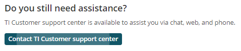

Try starting here. https://www.ti.com/guidedsupport/call-ti-support
Near the bottom of this page will be this button. Click the one the web page. Not the e2e picture
A few contact options are listed, I expect at least one will be helpful.
