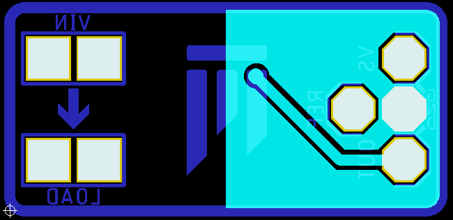

We use INA250A4PWR in our products. When testing products, we noticed that we read different output values for the same load and supply values. We tested 20 pieces. Most of them(15 pieces) gives 4,16V output, but 5 of them gives 3,66 V output. in the technical document I could not see that this was something ordinary and I wanted to ask.
in the diagram below, we used adjustable regulator for supply. None of the tested products change the output voltage by changing the supply voltage as expected.

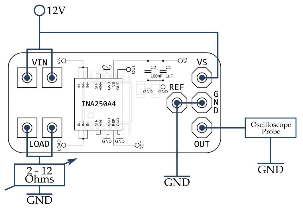

  • Hi Harun,
    is what we see the complete schematic?
    Kai

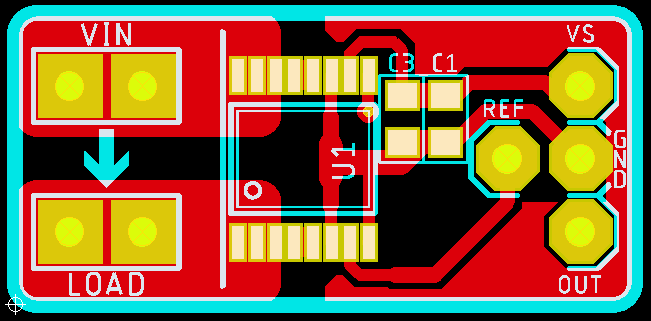

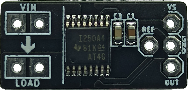

  • Hi Kai,
    These are the gerber views:
    Top:
    Bottom:
    This is what the PCB looks like:
    And this is the test circuit:
    I'll send you detailed test results when possible. But now we are looking for equivalent products as quickly as possible.

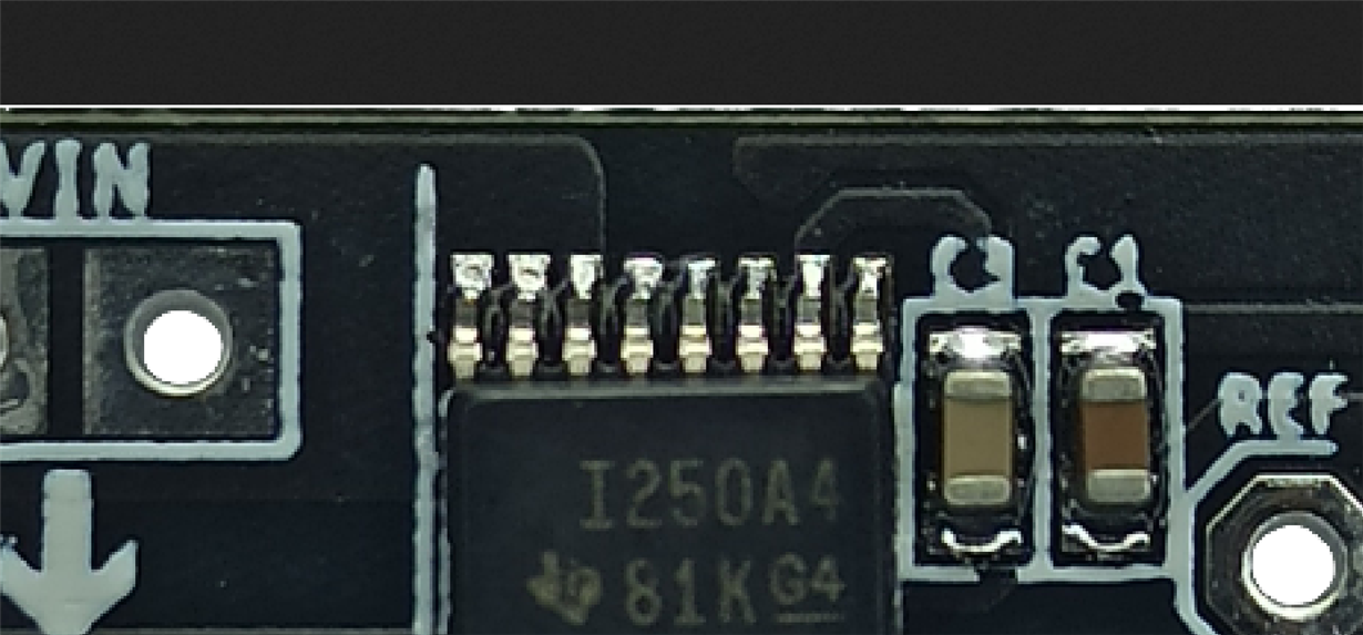

  • Hi Harun,
    are there are some shorts between the solder pins?
    Also, have you carried out a star point grounding in your measuring setup?
    Kai

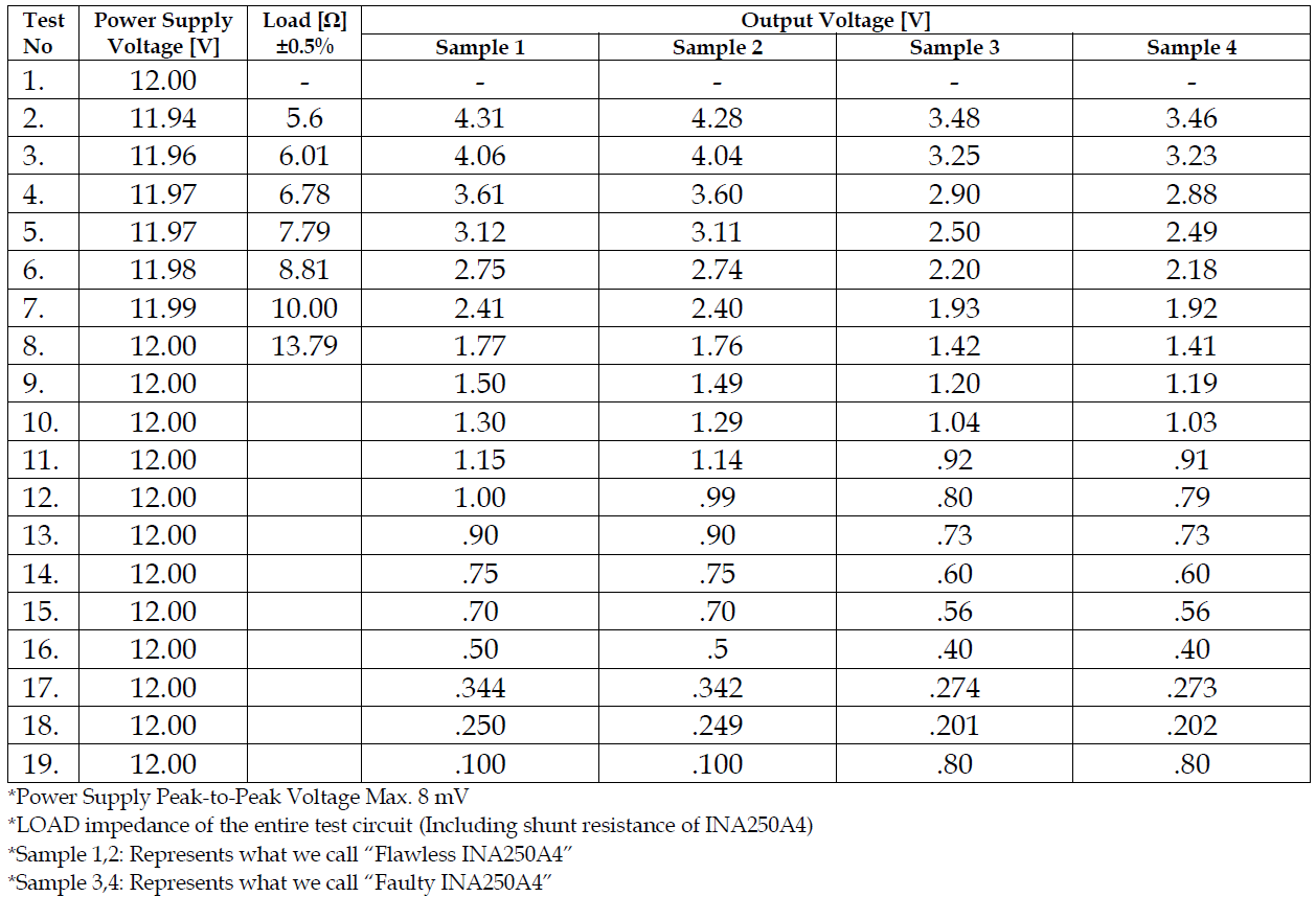

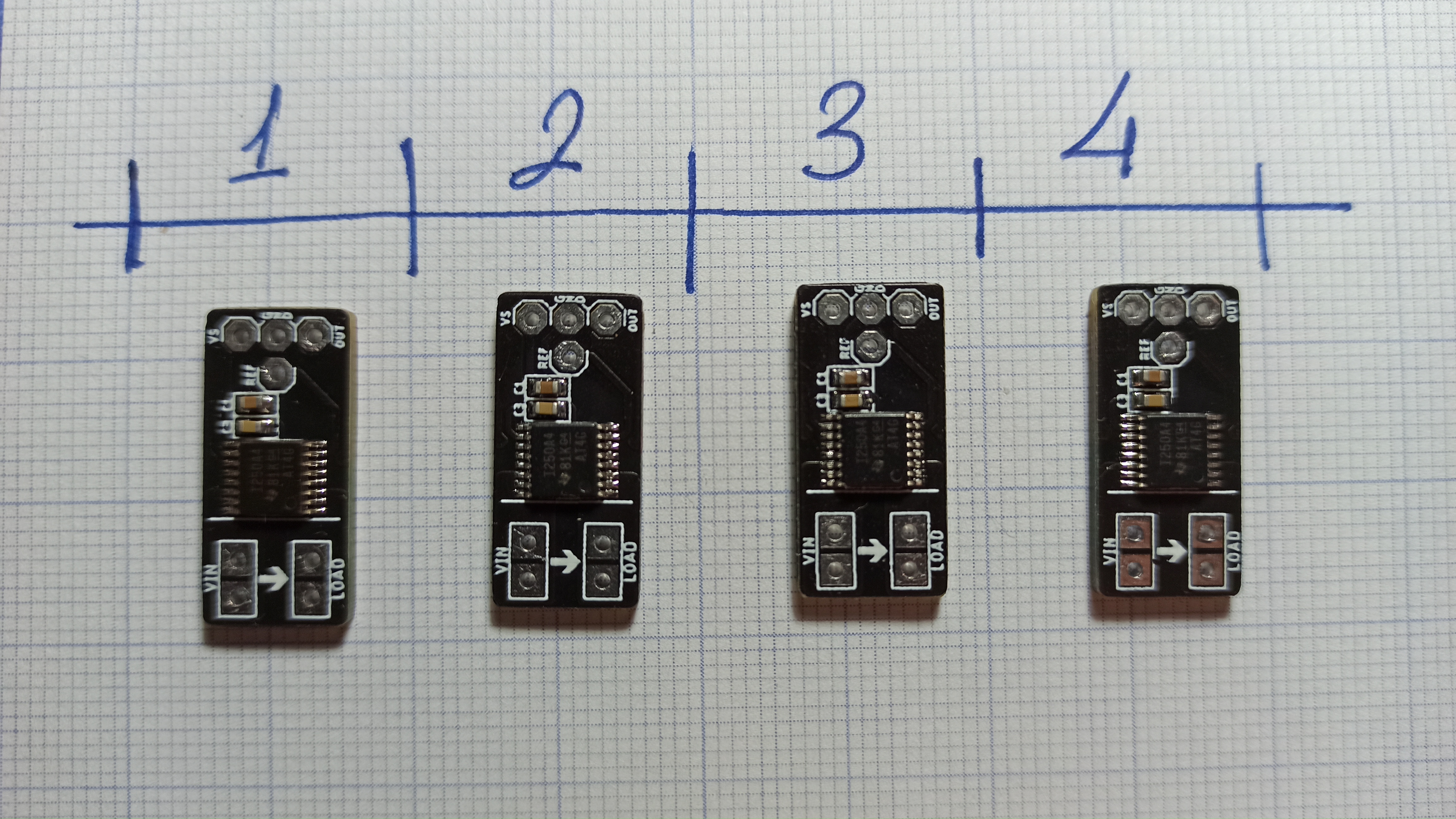

  • Hi Guang,
    Yes, the supply current is DC. For a quick test that can reveal the problem, we chose two subjects to represent the perfect circuits(Sample 1 and sample 2) and two subjects to represent the circuits that we thought were defective(Sample 3 and sample 4).
    This is the test result of four INA250A4:
    And these are the test subjects:
    Thank you for the data. The contrast is clear.
    Maybe you could insert a current meter in series with the load as anther means to measure the current. In addition you could try to swap INA250 between a good sample and a bad sample. Repeat the measurements to see if the defect travels with IC unit.
    Regards, Guang
  • -"you could try to swap INA250 between a good sample and a bad sample. Repeat the measurements to see if the defect travels with IC unit."
    We already tried this: we doubted the thickness of the stencil(0.12mm) if a short circuit may occur due to excess soldering. Several times we tried to switch ICs between good and bad samples but defect replaces with IC. Then we thought we should report this to this forum. We doubt whether the ICs we use are original or not. We cannot contact the place where we supplied the ICs. I think because of the virus.
