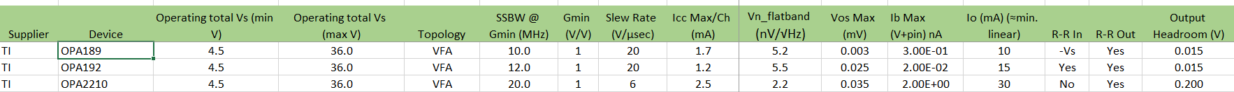

  • You need to have some bandwidth to provide a low output impedance over frequency to the load. Need to pick a part before proceeding too far, What DC load current do you need to support?

  • The ADCs, which there are two of, say 5.8mA typical...so multiply by 2 and add some margin. I was thinking that 20mA would be more than enough.
  • Here are some choices, I think you really want the best DC offset part for your needs - this is ascending worst case 25C Vos.
    That min linear Io is where the output headroom is >0.5V.
    That OPA2210 looks like the best fit but only available in a dual it seems.
    I would suggest we pursue the OPA192 as a solution.
    Could you perhaps close this one as resolved (getting pretty long) and open a new one on developing a precision -1.7V supply using the OPA192 And repeat that schematic as a starting point.
