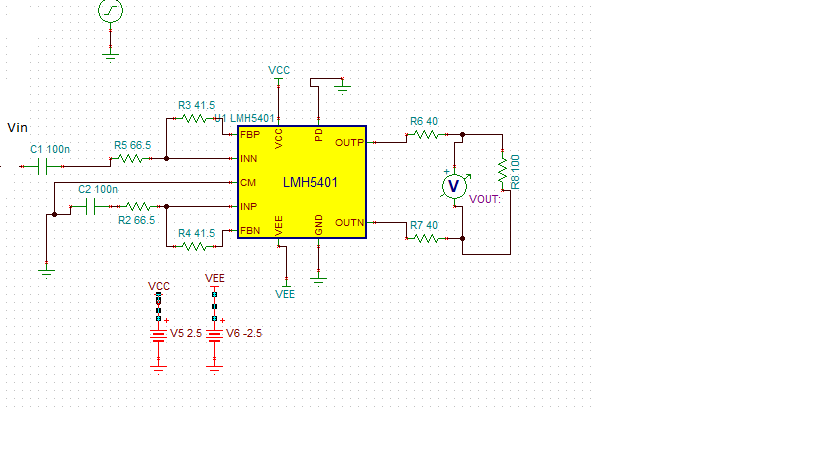

Hi Team,
I want to know that LMH5401 is stable for unity gain?.I am using this for single  to differential conversion.
Can i operate this for dual supply ie +2.5V & -2.5 V?
my signal frequency is 15 Mhz & Vpp=2V . Signal will be square or pulse .
I am using Vocm=0V

    no, the LMH5401 is not unity gain stable. Please read the datasheet (section 7.1, table 2, figure 56, etc.)
    Yes, you can operate the LMH5401 with +/-2.5V supply voltage.
    I would recommend to run the LMH5401 TINA Reference Design (Rev. B)

  • Why would you use an 8GHz part for a 15Mhz signal?
    you should perhaps use the THS4551.
    Recall, unity gain single to diff in an FDA is a noise gain of 2.

    Actually I need Ts (settling time < 10 ps).
     My application is for CCD waveforms . Along with that we are making our design for generalization like CRO.
    For upto 100 MHz BW, i require < 70 uVrms noise just input to ADC..Means echa Opamp should be  ultra low noisy.
    First stage we have Buffer & after that we have single to diffrential converor( which can supportunity gain along with other gain like 2, 4 etc).
    As these type of signal frequency is max 15 MHz & Vpp=2 ( or may be 4)
    Please suggest suitable components.
  • Sure, lets say you want 1% accuracy in 10psec - that is maybe 4 time constants, or 2.5psec implying a required amplifier bandwidth of 63GHz - good luck.

    It is 10 ns instead of 10 ps.
    Ts=*10 ns
    Could you suggest some P/N?
    Although I simulated LMH5401 through Tina. with Gain=1(For Vin= 10 MHz Square wave & Sine wave, 1Vpp)
    & Getting proper response without  oscillation.Is something i am doing wrong?
    Schematic is as follow:
  • Hi Shivakant,
    why are you doing this, if the datasheet does not recommend this?
    Kai
