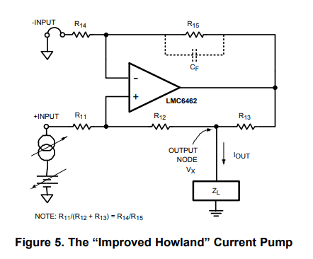

we will use two OPA564 configured as improved howland current source (SCH is refered to TI snoa474a Figure5. ), to drive two step motor coils (8.1ohm + 4.3mH), and we need to simulate the stability of this circuits.

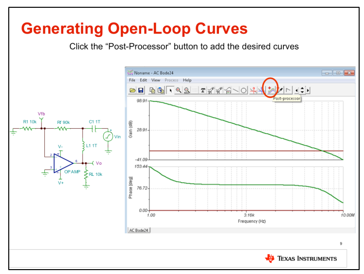

Although I learned on TI precision lab video 10.3 section, in simulation we should break the loop by using huge L and C in order to get loop-gain (as below), but  I have trouble on how to do this "break" on a howland circuit, because it is containing both negative and positvie feedback paths.
I searched on this forum and found this relaed original post(https://e2e.ti.com/support/amplifiers/f/14/t/678722) where  attached a 5047.OPA549 Howland Stability.pptxmay related to my question, but I did not understand the simulation configuration very well, hope some expert may help explain.

  • Hello Yi,
    A stability analysis of the Improved Howland Current Pump is highly involved and much more difficult than that for a simple voltage amplifier stage. That is because the pump relies on two feedback paths; one involving negative feedback, and the other positive feedback. Even with a purely resistive load a careful design is required to assure stability. The stabilization only becomes more questionable and usually more difficult when a complex load (R+/-jX) as being driven by the current pump.
    One of our former Precision Amplifiers team members worked to understand and provide a method for doing the stability analysis of the Improved Howland Current Pump circuit. The example power op amp circuit is driving a complex impedance load which is similar to what you want to do. I have attached slides from his TI Training presentation that he put together several years ago. The process he used for analyzing the stability is provided in the slides. I do not have any information beyond what is in the slides as they were presented live. Hopefully, there is enough detail to help you complete the analysis.
    Regards, Thomas
    Precision Amplifiers Applications Engineering
    Improved Howland Current Pump Stability_01.pdf

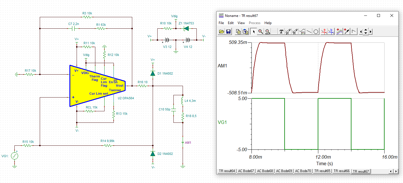

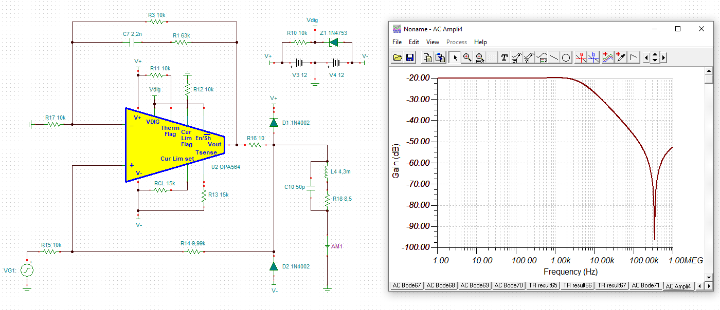

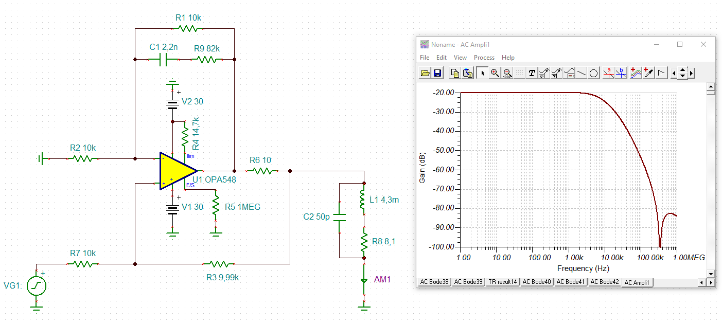

  • Hi Yi,
    only an example:
    yi_opa548.TSC
    And here the phase margin:
    yi_opa548_1.TSC
    Kai

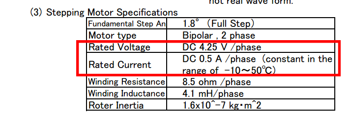

    (4) I checked again with motor coil spec : L1 = 4.1mH and R8=8.5ohm (Sorry for the inaccurate value), and coil current should be <0.5A, and voltage across two terminals of coil should be <4.5V. which means I will need to measure Voltage on two pins of R6 and current in R8.  And I did not use C2 in simulation.

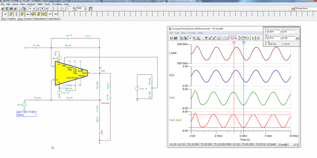

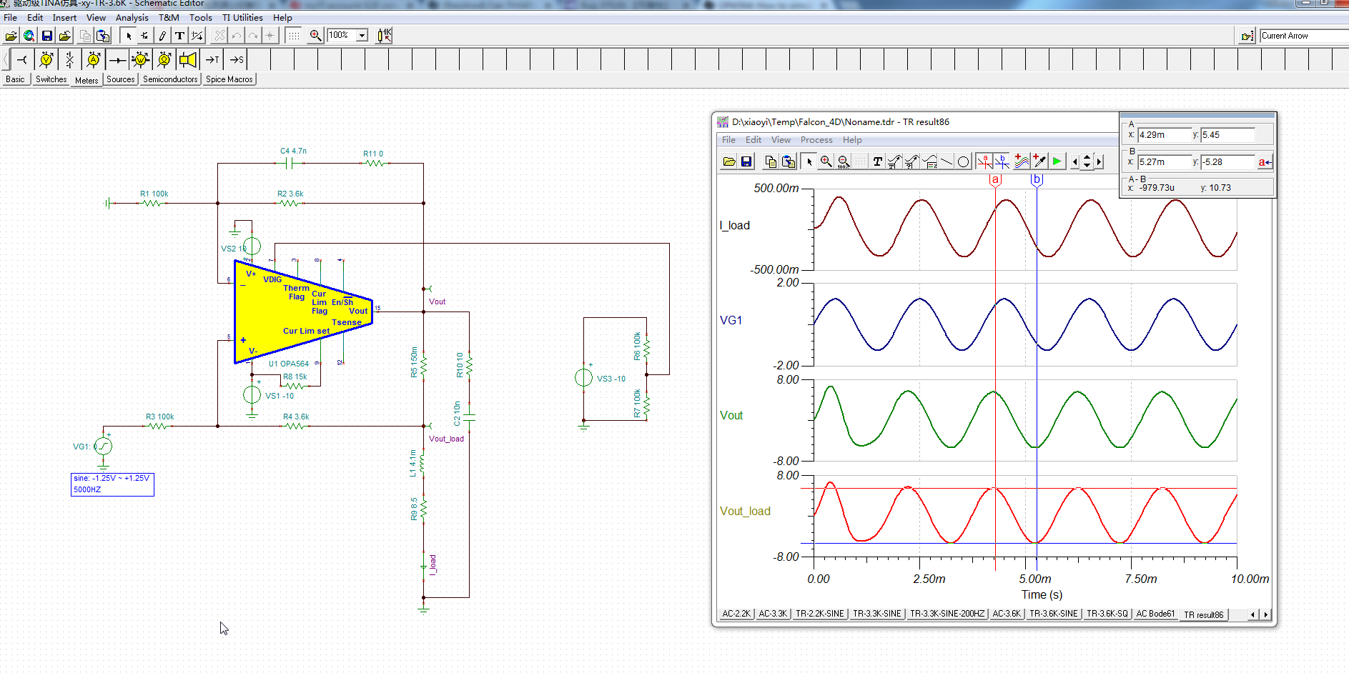

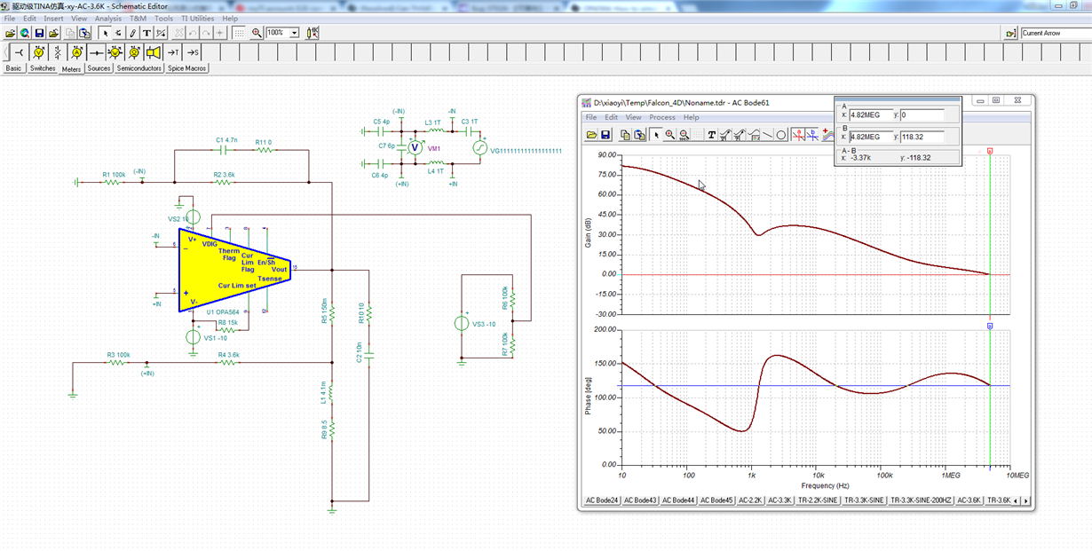

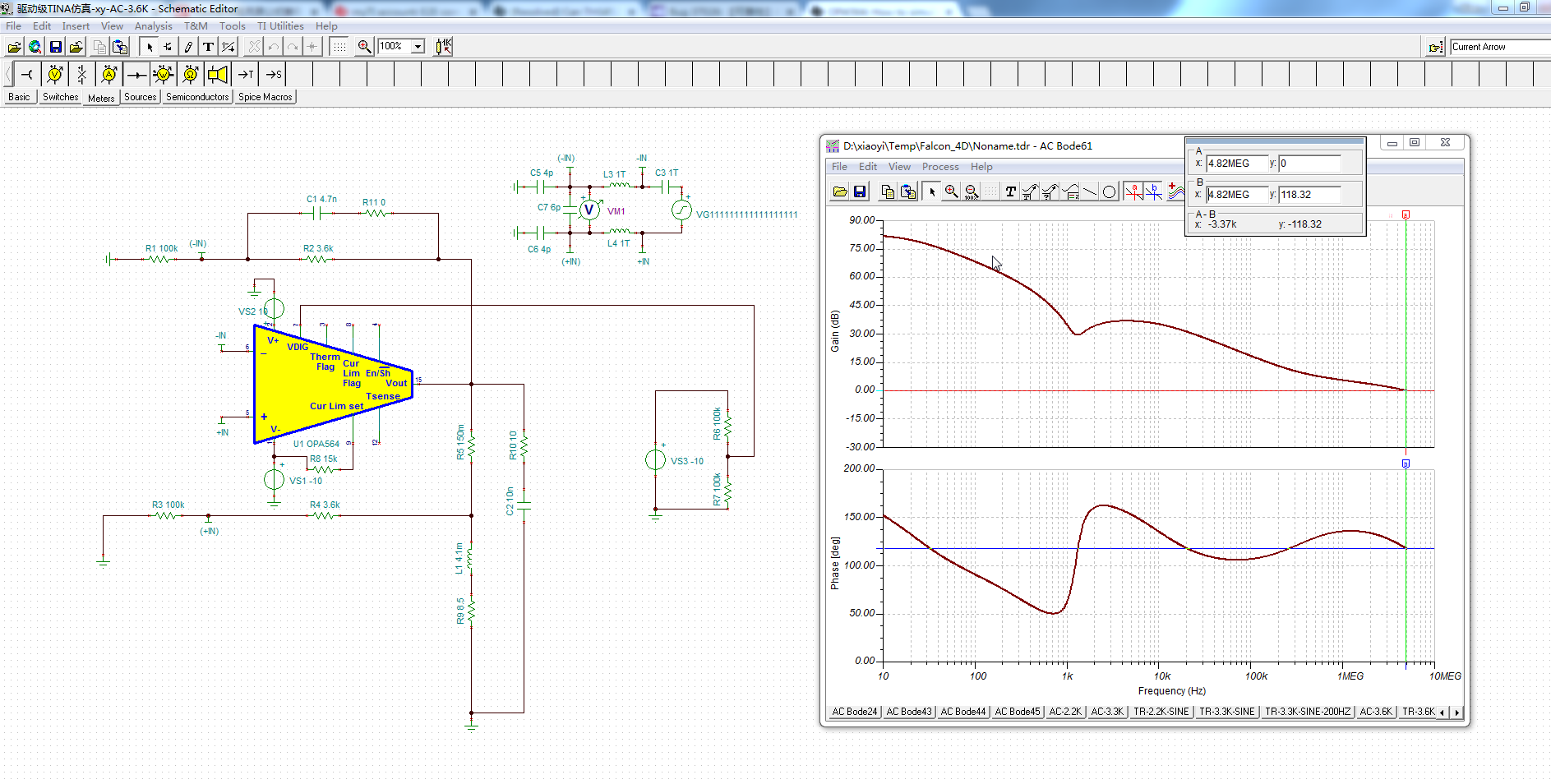

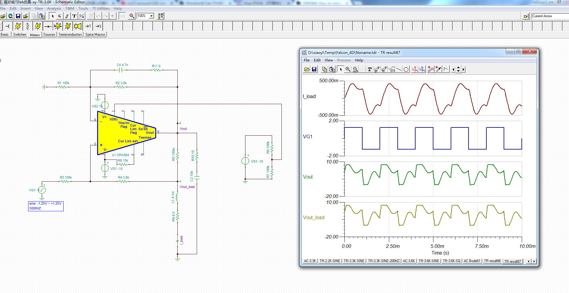

  • Hi Kai, here is my update. Attached TR and AC sim TINA files.  and motor coil spec.
    xy-TR.TSC
    xy-AC.TSC
    1. From AC analysis we can see the phase margin is good enough
    2. Transient response of 500Hz sine wave is good too, but the Vpp voltage on coil (Vout-load node in the SCH) is about 10Vpp, However , the bench test real waveform is about 18Vpp, this is confusing. This is far exceed the motor spec, I worried it would damage the coil
    The current Ipp is almost the same for simulation and bench test.
    3. Transient response for Square wave is really bad in simulation, compare with your plot.
    By the way, two OPA564 became very hot, and after I attached heatsink on the top pad, the temperature of the heatsink is around 50°C
    I would like to hear you comments, thanks again.

  • Hi Yi,
    if I had to use the OPA564, I would take this as a starting point:
    yi_opa564.TSC
    yi_opa564_1.TSC
    Kai
