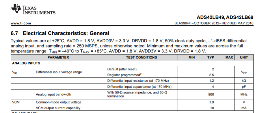

        Please advise on a DC coupled input circuit using the THS4509 and the ADS42LB69. Is it possible in the first place (because the ADC has a common mode input voltage)?
  • Well Certainly SM, that is what FDA's are for, simply tie the CM output of the ADC with an RC filter to the CM control input of the FDA, This ADC has a relatively high CM so the 2Vpp input range will be easily supported by the THS4509

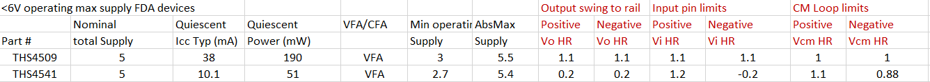

    3. Here is a table of I/O swing limits, you can use these to test operation at 3.3V supply with 1.9V cm and +/-0.5V max on each output pin. Might be close on the THS4509, but the THS4541 should be fine, The maximum output excursions are 1.4V to 2.4 around 1.9Vcm. The output headroom on the THS4509 is 1.1V so on 3.3V supply it would clip. The RRout THS4541 would not.
