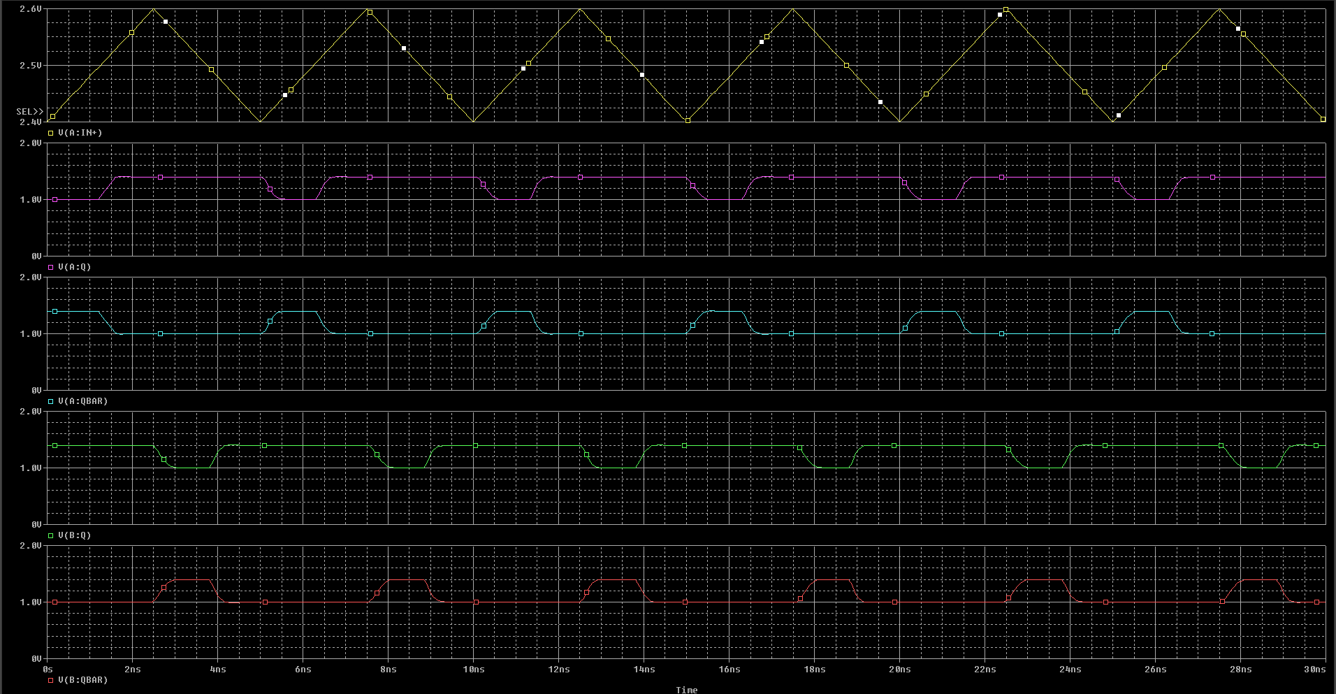

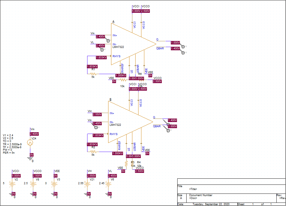

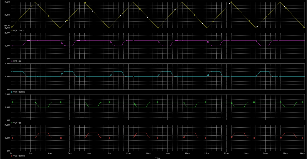

  •  Hi Srikanth,
    As depicted by the schematic, I used Channel A on the device in a non-inverting input configuration for your lower threshold (VL). I used channel B in an inverting input configuration for the high voltage threshold (VH=2.55V). The table below depicts the input/output behavior I implemented.
    INPUT Voltage Value
    Channel A Output
    Channel B output
    Vin<VL
    LOW
    HIGH
    VL<Vin<VH
    HIGH
    HIGH
    Vin>VH
    HIGH
    LOW

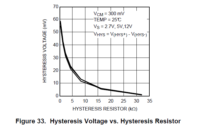

    The outputs are correctly in the LVDS output range (1.0V to 1.4V) and I have implemented minor hysteresis (20mV) using R5 and R6 corresponding to the plot I included from the datasheet.
    You can omit R5 and R6 to have no hysteresis. Please reach out if you think the simulation needs tweaking and/or if you would like me to change the design parameters.
    Joe
