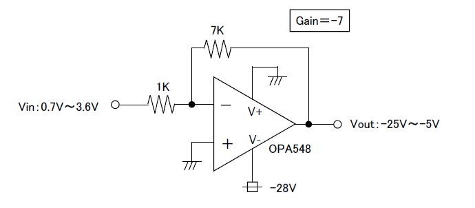

My customer is designing the following invert amp circuit.
So he has the following questions.
Please advise us

Raymond-san,
Thank you for your support. I understand your comments. I have one more question.
Please advise the circuit to meet the following customer's requirement.

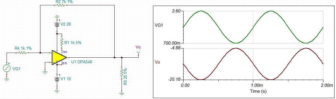

Hi Motoyasu-san,

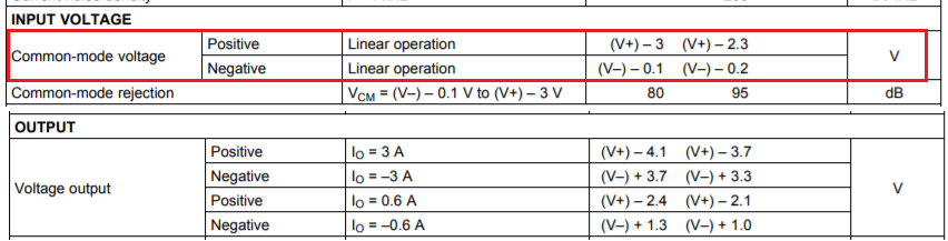

Design requirements:
If Vin = 3.6V, the required input Vcm is (V+) - 3V =3.6V, and this will result V+ needs to be a minimum 6.6V or V+ > 6.6V. In the simulation below, I picked the positive supply voltage at +10V, +8V will work as well.
/cfs-file/__key/communityserver-discussions-components-files/14/OPA548-Negative-Rail-10072020.TSC
If you have additional questions, please let us know.
BTW, the output voltage swing depends on the load, see the previous Vout requirements. If the customer is sinking heavier current, you may have to adjust the negative rail voltage accordingly or lower the circuit gain.
