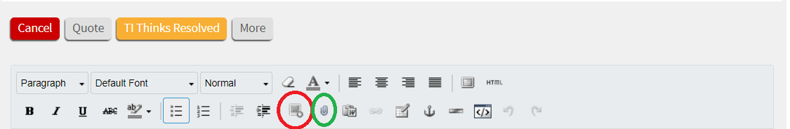

  • Hi David,
    Please use the red circled icon to upload your image.
    Raymond

    BTW, please use the clip icon inside of Green circle when you want to load a file. To load image (png, jpeg etc.) is using the icon in red.
    Raymond

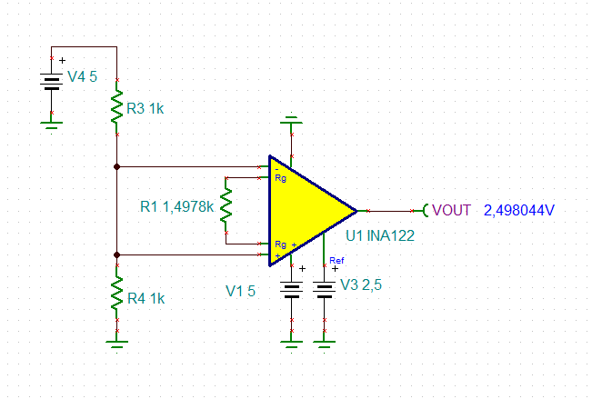

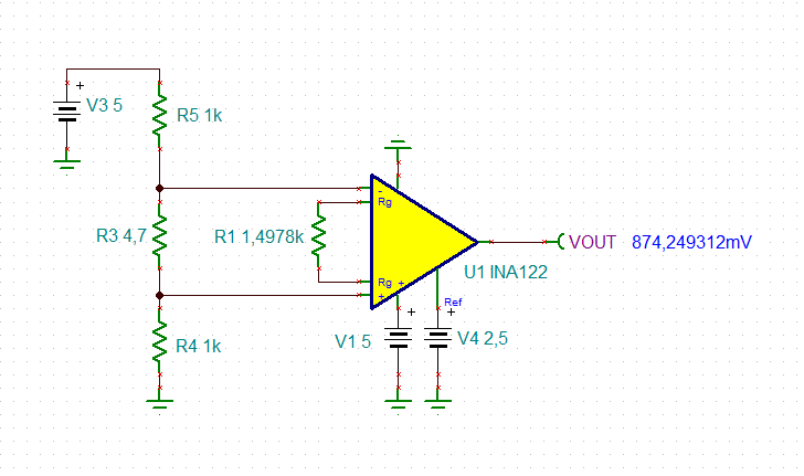

  • Hi David,

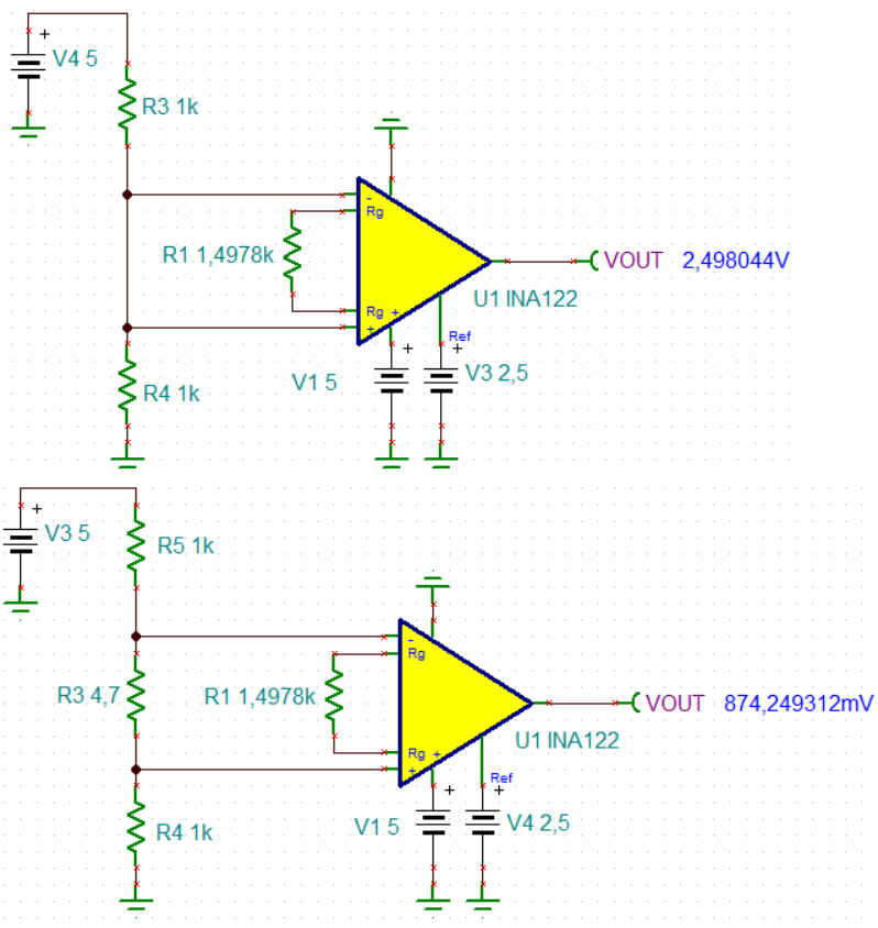

    the INA122 will not properly work with its input pins being unconnected because the input voltage (0V) is outside the common mode input voltage range:
    Because of this your measurements aren't very helpful, unfortunately.
    I would recommend a measurement which provides a common mode voltage of 2.5V to both inputs:
    Can you connect some resistors to the inputs of circuit as shown below and measure the output voltage of INA122?
    david_ina122.TSC
    Kai

  • Hi Dave,
    have carried out the measurements I have recommended in this post?
    Kai

    Please follow the Kai's measurement suggestions in U6 of INA122.

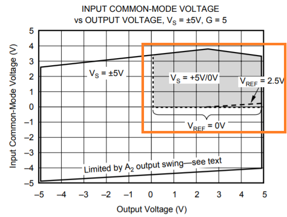

  • Hi Dave,
    Thanks for the more information. Now we have some information to go on.
    Were the input resistances on both input pins of INA122 measured at 58kOhm? Please confirm this.
    Have you verified that the measurement technique described by Kai in the previous reply. I would like to know, what will be the output, if the DC bias voltage was placed at its input. I want to know how badly INA122 is damaged.
    This is a locomotive application. The excitation voltage to the transducer is 10Vdc. The load cell is SOB-3K-C type (Compression), and some cell specification can be found in the following site.
    https://www.thomasnet.com/catalogs/item/354471-8357-1019-1297/transducer-techniques-llc/sbo-series-3000-pound-lb-capacity-universal_tension_compression-precision-beam-load-cell/

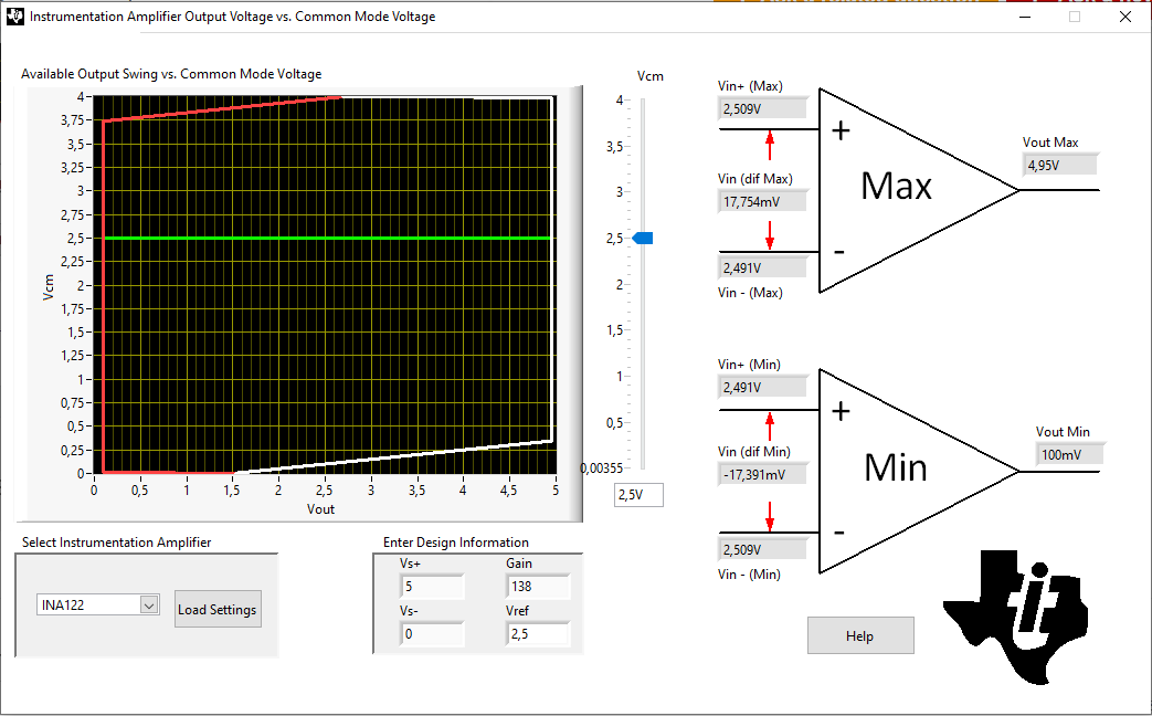

    The nominal transducer's resistance is 350 Ohm. Let us assume that this is wheatstone bridge sensor configuration, the maximum input current through the bridge is 14.29mA.  And the input DC bias or Vcm at INA122's input is 5*75k/(75k+348)=4.977V.
    From the datasheet, the max. Vcm for INA122 should be configured below 3.4V. Since the application is configured at 4.977V, this may be a reason that the part is damaged prematurely due to EOS. In addition, the max. input current in INA122 should be limited to 5mA. The schematic is shown that the input current may go up to 14mA or so.
    I think that we may be able to change some resistor values and fix the issues. Please let us know how you'd like to proceed.
    By the way, all the damaged components are repairable. If this is indeed due to EOS, it can be fixed readily.
    Raymond

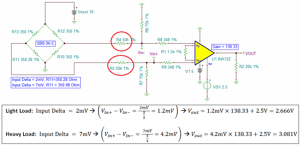

  • Hi Dave,
    I contacted the transducer's manufacture (Transducer Techniques, LLC), and It is likely that the "damaged INA122" is a case of Electrical Over Stress at input based on the information that you are given, and manufacture's datasheet + support.
    /cfs-file/__key/communityserver-discussions-components-files/14/INA122-SOB_2D00_3K_2D00_C-07272020.TSC
    Here are two modification options, I'd like you to make a decision.
    1. If SB0-3K transducer's excitation voltage is reduced from 10.0V to 5.0V, then no circuit modification is required.
    2. If you want to leave the transducer's excitation voltage unchanged, we have to change the resistor values at INA122's input.
    Here is the justification from case #1.
    The SB0-3K transducer is rated from 0-3000 lb of compression forc, and it has nominal rated output at 3mV/V. In addition, the sensor's excitation voltage can be selected from 1-12V based from the manufacturer's support.
    At Vexcitation = 10V, the maximum differential sensor's output is 3mV/V*10V=30mV, At the differential 30mV, the compression force is proportional to 3000 lb.
    With application input range of 2-7mV, the application is measuring the compression force range form 200 lb to 700 lb per the application.
    If you are using Vexcitation = 5V, the maximum differential sensor's output is 3mV/V*5V=15mV, where 15mV represents 3000lb of compression force.
    Therefore, if the Vexcitation=5V is used, the transducer's differential output will be from 1mV to 3.5mV.
    With Gain=138.33 V/V, For 1mV input, Vout = 2.5 + 138.33V/V*1mV= 2.638V. For 3.5mV, Vout = 2.5V + 138.33V/V*3.5mV = 2.98416V.
    The software or display may have to be modified.
    In the case #2 above, with resistor value changes at input, the INA122's output voltage will be different from before, and you still have to change the software or display that reports the compression values as well, also, you will require to do modification on very boards in the field.
    Raymond

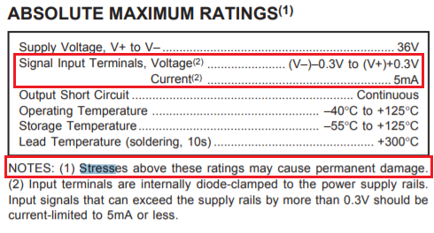

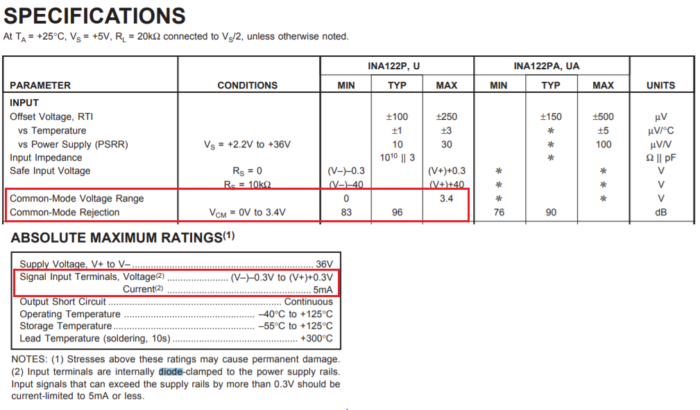

  • Hi David,
    The INA122 is operated at 5Vdc and Ground. The load cell's excitation voltage is operated at 10Vdc and Ground. Two electrically overstressed conditions happened in the design application.
    1. Load cell's Input voltages at Vin+ and Vin- exceed the maximum allowed input Common-mode Voltage of 3.4Vdc.
    2.  The input current at Vin+ and Vin- may be as high as 7.2mA, if input terminal voltage is greater than (V+)+0.3V during power up, power down or transient power interrupt events. The current in the clamping diodes should be less than 5 mA under these events.
    Without X-ray image analysis, it is hard to say which one is damaged first. The over voltage stress over input pins in scenario #1 are occurring constantly. Hence, I will speculate that the input impedance at Vin+ and Vin- are damaged due to the EOS. The nominal input impedance of Vin+ and Vin- are rated 10^10 Ohm. The EOS may create some kind of short at its input, and create parallel resistive path to ground in an order of 255 kOhm.
    Raymond

  • Hi Dave,
    Yes, If your customer wants to leave 10.00V excitation voltage alone, then one of the option is to change two resistor values. I am talking about the minimum modification at this point.
    The INA122's input Vcm voltage is changed from 4.97Vdc to 3.00Vdc., which is within the required 0 < Input_Vcm < 3.4Vdc range.
    With the change, you still have to change the equation in the software to reflect the load conditions at the sensor.
    The SB0-3K transducer is rated from 0-3000 lb of compression force, and it has nominal rated output at 3mV/V. With excitation voltage = 10.0V, 30mV represents 3000 lb in full load scale. With 2mV delta change at the transducer, it is equivalent to 2mV/30mV*3000 lb = 200 lb or Vout = 2.666V. with 7mV delta change at the transducer, it is equivalent to 7mV/30mV*3000 lb = 700 lb or Vout = 3.081V.  Without the load or 0 lb, Vout = 2.50V.
    /cfs-file/__key/communityserver-discussions-components-files/14/INA122-SOB_2D00_3K_2D00_C-08192020.TSC
    If you have other questions, please let me know.
