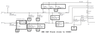

Hi, Support Team
Could help review MIC schematic as below chart:
if any suggestion, Please advise me.
Lawrence
Hi, Support Team
Lawrence
Hi Lawrence,
Everything looks fine except for the MICBIAS connection. Typically only the positive side of the microphone needs the MICBIAS while the negative side uses a resistor to GND to bias the negative side. Double check your microphone datasheet and refer to Figure 188 in the AIC3109 datasheet.
Jeff McPherson
