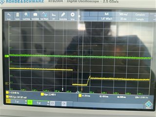

  • Yes. I do see the Micdet pin on oscilloscope(Yellow line as per attachment). No effect on 0x43 register.
    Also connect Micdet directly to ground instead of inserting headset.
    What are the more register settings requires?

    On the hardware side, I can see from your scope capture that MICDET goes low close to 0V, but then it rises to about half of the supply. This is not OK as the detection would consider this as "no insert". Can you comment why is it not stay low? That should fix the detection.

  • Hi Ivan,
    I able to resolve the issue by setting page3/register 10.
    Thank you so much for your support
